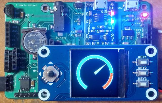

Please find attached version 5.05.05 for the Armmite L4
2019-01-10_204755_ArmmiteL4.zip
This includes the following changes:
Added triangle command with array support - see H7 manual for syntax
Added ARC command - see H7 manual for syntax
Added Bezier command - see H7 manual for syntax
Added support for ST7789 display as in pictures
OPTION LCDPANEL ST7789, orientation, DCpin, RESETpin, CSpin
Added support for ST7735S display as per recent CFunction. NB: there appear to be two variants of this. I'll add support for the second variant when I have confirmed the initialisation differences
OPTION LCDPANEL ST7735S, orientation, DCpin, RESETpin, CSpin
Final decision to run single precision floating point on the L4. This saves a huge amount of flash memory for additional features and is faster. Applications that need double precision should use an alternative platform.
The triangle command is highly optimised when outputting to colour displays in order to allow flicker free updates to the screen as per the video
As there were reported issues I have bought a couple of HTU21D sensors and can confirm they work perfectly for me on the Armmite L4 using TassyJim's code
Video of demo code
Dim integer x1(1),y1(1),x2(1),y2(1),x3(1),y3(1)
Dim integer c(1)=(0,RGB(yellow)),c2(1)=(0,RGB(yellow))
Dim integer x1s,y1s,x2s,y2s,x3s,y3s
CLS
x1(1)=MM.HRes\2-6 :x1(0)=x1(1) :x1s=x1(0)
y1(1)=MM.VRes\2 :y1(0)=y1(1) :y1s=y1(0)
x2(1)=MM.HRes\2+6 :x2(0)=x2(1) :x2s=x2(0)
y2(1)=MM.VRes\2 :y2(0)=y2(1) :y2s=y2(0)
x3(1)=MM.HRes\2 :x3(0)=x3(1) :x3s=x3(0)
y3(1)=MM.VRes\2-75 :y3(0)=y3(1) :y3s=y3(0)
Arc MM.HRes\2,MM.VRes\2,99,101,210,150
Arc MM.HRes\2,MM.VRes\2,84,86,210,150
Arc MM.HRes\2,MM.VRes\2,86,99,210,90,RGB(green)
Arc MM.HRes\2,MM.VRes\2,86,99,90,150,RGB(red)
Pause 1000
rotatetriangle -150,MM.HRes\2, MM.VRes\2
For i=-150 To 150
If(i>90)Then
c2(1)=RGB(red)
c(1)=RGB(yellow)
Else
c2(1)=RGB(yellow)
c(1)=RGB(red)
EndIf
rotatetriangle i,MM.HRes\2, MM.VRes\2
Triangle x1(),y1(),x2(),y2(),x3(),y3(),c(),c2()
Next i
For i=150 To -150 Step -1
If(i>90)Then
c2(1)=RGB(red)
c(1)=RGB(yellow)
Else
c2(1)=RGB(yellow)
c(1)=RGB(red)
EndIf
Next i
Loop
Sub rotatetriangle(angle As float, x As integer, y As integer)
Local float sine=Sin(Rad(angle)),cosine=Cos(Rad(angle))
Local integer x1a=x1s-x, y1a=y1s-y
Local integer x2a=x2s-x, y2a=y2s-y
Local integer x3a=x3s-x, y3a=y3s-y
x1(0)=x1(1):x2(0)=x2(1):x3(0)=x3(1)
y1(0)=y1(1):y2(0)=y2(1):y3(0)=y3(1)
x1(1)= x1a*cosine - y1a * sine + x
y1(1)= y1a*cosine + x1a * sine + y
x2(1)= x2a*cosine - y2a * sine + x
y2(1)= y2a*cosine + x2a * sine + y
x3(1)= x3a*cosine - y3a * sine + x
y3(1)= y3a*cosine + x3a * sine + y
End Sub

Hi Peter,
The ST7789 based display looks fantastic!
Ref my last post concerning ST7789 based 240 x 240 displays - after quite a lot of digging around, I have finally alighted on using an AMELIN AML015416 V3 SPI i/f with Capacitive Touch Screen display, which uses the ST7789 and FT6336 touch controller:-
https://amelin.en.alibaba.com/product/60841978417-806620495/Brand_new_1_54_inch_240_240_TFT_LCD_screen_SPI_interface_wit _CTP_touch_panel.html?spm=a2700.icbuShop.41413.15.7b4b4d36UwKuzl
I think that this display probably represents the best balance between quality and value.
Additionally,this is a new generation of this type of display, where both the LCD SPI and Capacitive Touch Screen I2C connectors are brought out to a single 24 way Hirose connector, resolving the issue of having to solder multiple (fragile) flexible pcbs.
