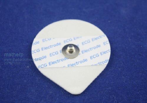

To do this you need some of these

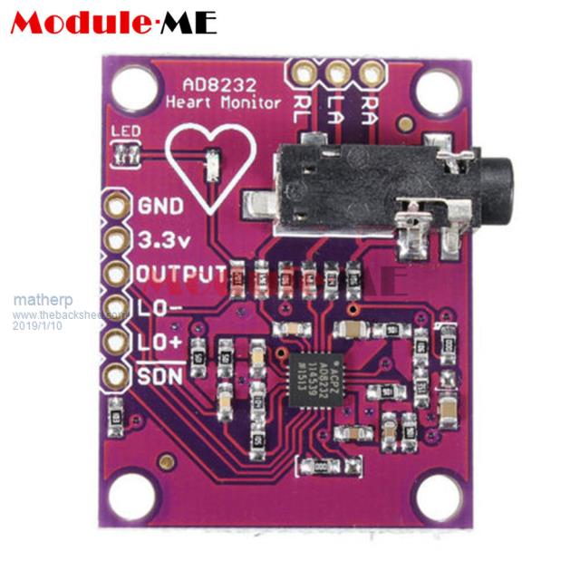

One of these

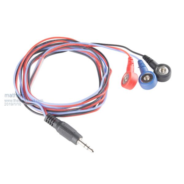

and a set of these

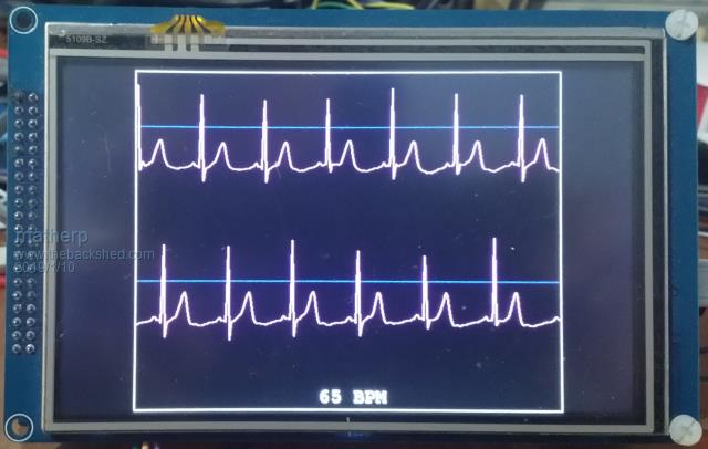

All very cheap and then just add some very simple code.
The code is set up for 50Hz mains voltage. The amplifier is extremely sensitive and picks up 50Hz noise from the environment. The code averages 80 samples every 20mSec in order minimise this and as shown in the picture this works pretty well. For 60Hz operation you will need to adjust the mains frequency, samples per second and number of samples in order to filter the noise and get the right number of samples across the screen. I'm using a 5" SSD1963 in 16-bit mode but any display could work by adjusting the display parameters.
The code as written uses the huge memory on the H7 and the background ADC sampling but could be re-written for other Micromites. Note, the code also needed a change to the H7 firmware to overcome a limit on the maximum array size of 32767. This change will be included in the next H7 release.

Posted: 02:03am 10 Jan 2019
I already have a monitor but for the price, I had to order a module to play with.

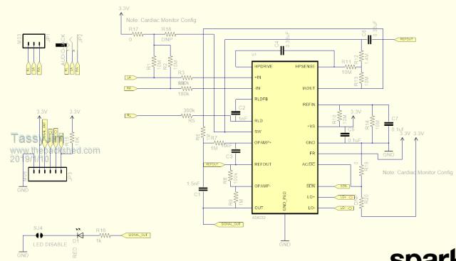

Sparkfun have a good writeup of the module and a link to the github page which has the circuit for the module in Eagle format.
I assume it's the same design!
And the image in a ZIP so it's readable.
2019-01-10_120253_AD8232.zip
