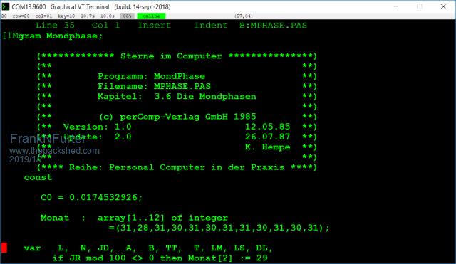

I have great pleasure with my small Z80 computer (Z80-MBC2 - many thanks to Jman!) but a VT100 problem with GFXterm, Geoff's - ASCII Video Terminal and TurboPascal 3.0!
As an example, my moon phases program:
All works great with Teraterm, but unfortunately not with Geoff's Terminal and not with GFXterm.

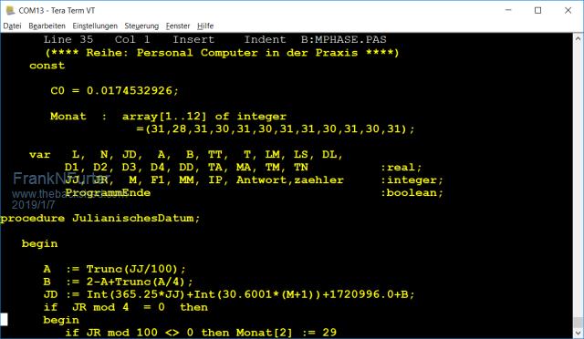

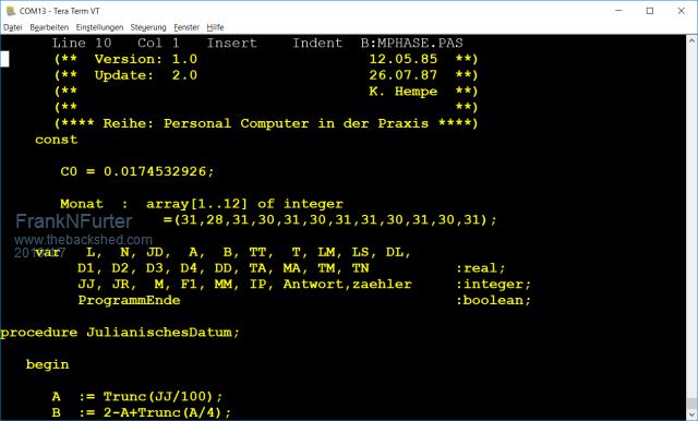

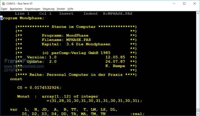

When I start the editor, everything seems to be normal:
...but when I scroll down:

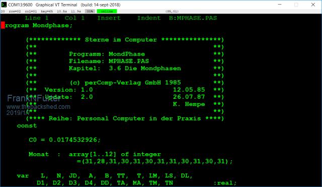

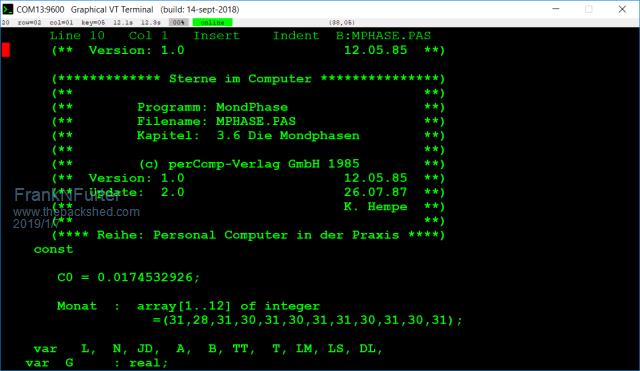

...only the last line is updated! When I scroll back
only the first line is updated!!!
What's going on? Unfortunately it looks the same on an external monitor with Geoff's VT100 terminal!
I know not all VT100 control codes have been implemented, but is that the reason? ...or does TurboPascal use any exotic codes?
