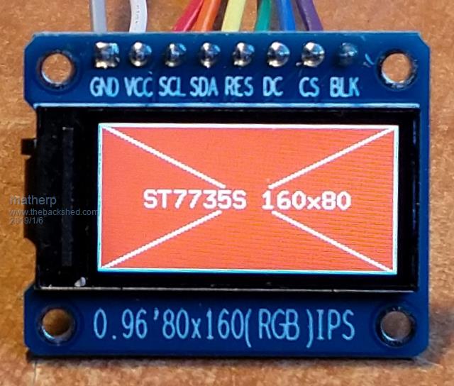

I've been looking for small low power displays for the Armmite L4 and came across this. Ideal for adding a "small" (pencil for scale) touch of colour rather than the SSD1306 etc.

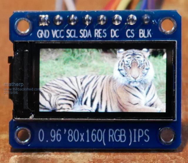

Loadable drivers for the MM2 and MM+ below. MM+ supports image load.

I have been trying to track Peter's prolific output of display drivers so that I can list them in the Micromite firmware distribution. So far the count is twelve and I am sure that I have missed some.
An amazing record.
Posts: 2998
Posted: 05:25pm 06 Jan 2019
Hi Peter,
Two main questions if I may:
1> What is the BLK pin for? Backlight?
2> Is the display's viewing angle any good? (or do the colours 'wash out? If compared to OLED RGB, is this IPS TFT comparable?
Posted: 07:00pm 06 Jan 2019
  Quote  What is the BLK pin for? Backlight?
Yes
  Quote  Is the display's viewing angle any good?
Same as any other IPS display, very clear and bright
  Quote  If compared to OLED RGB, is this IPS TFT comparable?
No - it is 1/10th of the price

Posted: 12:33pm 09 Jan 2019
Hi Peter,
Just received my IPS display - all hooked up to a 28pinner with MMBASIC v5.05.01.
Using MM2 driver from Page 1 of this thread.
Am using the pins 2, 23, and 6 for the user defined pins (i.e. identical to the 2.8" ILI pins). Orientation 1.
It kind of works but I think there may be a RGB data 'INVERT' issue.
All other functions seem to work - i.e. TEXT, BOX, etc. Displays as expected APART from colours are incorrect.
On boot up, display is white (as opposed to black). CLS RGB(WHITE) will clear it (i.e. goes black).
CLS goes back to white.
CLS RGB(BLUE) goes to yellow
CLS RGB(YELLOW) goes to Blue
Hopefully enough there for you to see the 'pattern'
Note too that there is a white 'shimmering' edge to the screen (yes - I know I am sensitive to this )
Hope you can possibly see something wrong somewhere!
WW
Posted: 12:53pm 09 Jan 2019
Sounds like you have a different controller version - please provide a link to where you bought it.
In the mean time search for 24040021 and replace it with 24040020. There may be other changes but start with that.
Assuming that works: Type "box 0,0,mm.hres,mm.vres" in all 4 orientations and let me know the result. Also the me know if red and blue are swappedEdited by matherp 2019-01-10
Posts: 2998
Posted: 12:57pm 09 Jan 2019
  matherp said   Sounds like you have a different controller version - please provide a link to where you bought it.
https://www.ebay.co.uk/itm/264089081686
Paid higher price as UK supplier (got here quickly!)
WWEdited by WhiteWizzard 2019-01-10
Posts: 2998
Posted: 01:08pm 09 Jan 2019
  matherp said  In the mean time search for 24040021 and replace it with 24040020. There may be other changes but start with that.
One occurrence - and that has corrected all the colours (certainly for CLS RGB(....))
Still have a pixelated edge on Left and Top sides only (as before). Seems like a one pixel offset (in both down and right).
With the BOX 0,0,... command, I get the left and top edges of the box NEXT to the pixelated lines (i.e. down, and to the right). No Right or Bottom lines to the box (off-screen I assume due to offset issue?)
THANKS for helping - looks like a nice clear display (and very tiny!)
Will try the other orientations next; back soon with outcome . . . Edited by WhiteWizzard 2019-01-10
Posts: 2998
Posted: 01:25pm 09 Jan 2019
Upon Reset:
Orientation 2: (but with screen physically landscape; and pins along top edge): get pixelated line on left, and green(I think) line along bottom.
Orientation 3: Green line at bottom. No other lines
Orientation 4: Green dot in bottom right corner
and Back to Orientation 1: now there's no lines on left or top ??? BOX still shows top and left lines only
Will now go and do the BOX in each orientation . . .

Starting at Orientation 1: Blank on Reset. Left and Top Box lines only. Offset down and to the right
Orientation 2: Now only a white dot in lower left corner ? Box: Left and bottom lines only.
Orientation 3: white dot in each of bottom corners. Box: Bottom and Right lines only
Orientation 4: white dot in two right corners. Box: Right and Top lines only
NOTE: These tests were carried out with the code in Program Memory, and not the LIBRARY. Edited Orientation value, F1, Reset (Rst pin to GND), then observed, and did the BOX command.Edited by WhiteWizzard 2019-01-10
