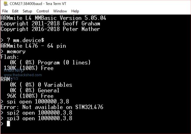

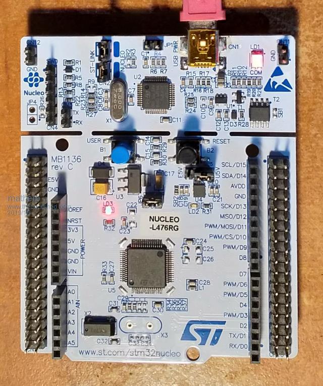

This release includes support for the STM32L476RG as used on the NUCLEO-L476RG. The same binary is used for all supported L4 devices.
The STM32L476RG has the advantage of more RAM and more flash memory but due to a pin conflict it loses one of the three SPI ports.
MM.DEVICE$ now returns "Armmite L476 - 64 pin" for the STM32L476RG and "Armmite L43x - nn pin" for the L43x series devices

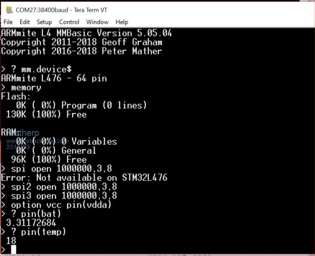

and specific measurements of the chip characteristics
PIN(TEMP) ' returns the die temperature of the chip
PIN(VDDA) ' returns the calculated value of the analogue reference voltage
PIN(BAT) ' returns the RTC battery voltage
PIN(SREF) ' returns the measured internal reference voltage with a VDDA of exactly 3.0V
PIN(VDDA) seems to give a higher voltage than would be expected (approximately 3.4V with an real input of 3.3V) but using it to set OPTION VCC does seem to yield more accurate analogue readings - for example to accurately read the RTC battery voltage use:
OPTION VCC PIN(VDDA)
PRINT PIN(BAT)

Some problems with the L476 - I am using an Arduino shield with the Winbond 25Q32 on it wired as per your instructions. I have wired D8 on the shield as the 25Q32 chip select line. So, starting up ...
> ARMmite L4 MMBasic Version 5.05.04
Copyright 2011-2018 Geoff Graham
Copyright 2016-2018 Peter Mather
> print mm.device$
ARMmite L476 - 64 pin
> print mm.ver
5.0504
> option vcc pin(vdda)
> print pin(bat)
3.302277252
> print pin(temp)
16
... all OK so far.

This minor update allows you to use the Arduino nomenclature for pins on the NUCLEO-L476RG or NUCLEO-L433RC, e.g.
SETPIN A1,AIN
SETPIN D2,DOUT
PIN(D2)=1
PRINT PIN(A1)
2019-01-05_203903_ArmmiteL4.zip
Note: the special functions assigned to the pins do not map the silkscreening on the Nucleo - see table below. Also D0 and D1 are the console pins so cannot be used for normal I/O
