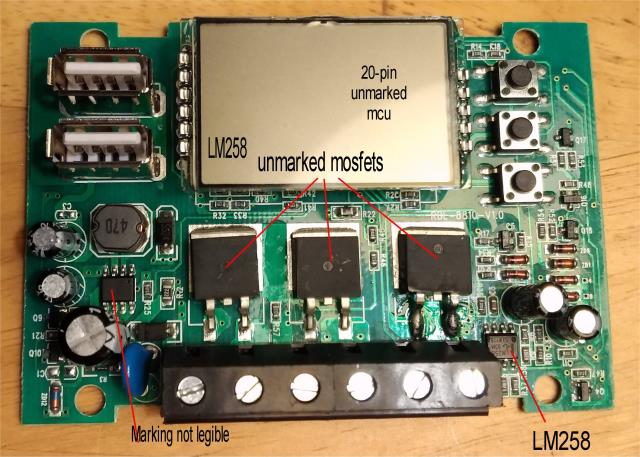

But why not? I bought 2 of them so I could tear one down to see if anything clearly could not handle a 15V wall wart. But I'm not so experienced, so I'd like other eyes to look.
Tear-down is too strong a term. The case snapped open, and a pcb with components on only one side appeared.
The 20-pin mcu is under the elevated LCD, with markings sanded off. There are two LM258s, 3 mosfets with markings removed, and an 8-pin IC near the caps and inductor, also unmarked.
I don't see any inherent reason why I couldn't feed 15 volts where the solar is to come in and maintain my 12V 7Ah SLA battery with over-voltage and under-voltage protection for my (light) load. Of course, it doesn't have any safety markings, but neither would anything that I made. If it works, for less than $9, it's not worth my spending any more time trying to make something myself.

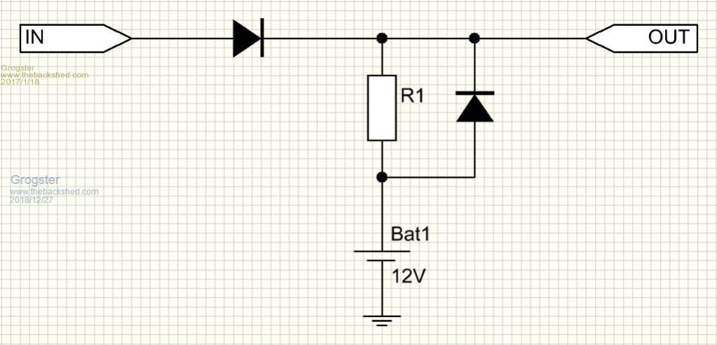

SLA's can be trickle-charged with nothing more then a diode and resistor, which would be even cheaper then $5. It is common to find those trickle-charger arrangements in security PSU's to keep the backup batteries at full charge. The only thing they can't do, is fast-charge, so if you flatten the battery badly, it will take a long time for it to trickle-charge back up. Still, for backup things where the load on battery would not be that huge, the simple diode-gate is just about everywhere.
R1 sets the battery charge rate. The two diodes form the gate. The diode across the charging resistor bypasses the resistor when the main-power fails, so the battery can power the circuit. The series diode in the V+ line prevents the 12v battery voltage going back down into the OUTPUT of the mains PSU when it has lost it's power - which would not be a good thing, in general. For loads up to 1A, a couple of 1N4007 diodes(or Schottky's if you wanted a lower voltage drop), and a 33R 1W resistor - done.
This is assuming at 13.8v supply. For 15v, I would just daisy-chain two series diodes in the V+ input, which will drop about 1.2v, leaving you with 13.8v on the battery, and that is spot-on perfect charge voltage for a SLA.

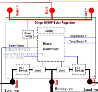

What does this mean? "so be careful about tying grounds together"
The schematic below shows a common +ve solar controller. This has the controlling FETs in the -ve side, so you cannot join the -ve of the solar, the battery or the load together without shorting out the FETs inside the controller.
If you just connect the solar to its terminals, the battery to its terminals and the load to its terminals it is good.
You can't for example connect the battery -ve to the chassis and then try to also use the chassis for the return circuit for one of the loads.

I have cut this from a circuit I drew up for my caravan.
On my van the house battery -ve is connected to the chassis. None of the loads connected to the solar controller use an earth return, all have a separate return path to the -ve load terminal.

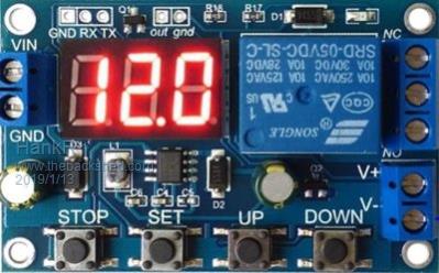

The low-voltage cutout protection is available in several type of modules on ebay and no doubt elsewhere.
I think you can be happy with one of these specifically designed modules (not necessarily selected from these below). I believe this will be better than improvising with a solar controller. The basic charging circuit to use with these can be the trickle charge circuit shown by G., but it doesn't have to be.

You're welcome. I think the dry contacts provided by the use of the relay are nice to have -- can come in very handy. No thinking required as to bad effects of improper grounding that can arise with solid state device switching. :)

Just received this unit which is a dual programmed cutout with relay. Dual being switches together with LED readout, or serial port.
Under $4 US believe it or not! At that price I couldn't resist ordering and it got here quite fast.
Not a stitch of instructions included, not even one of those nice 2 inch by 2 inch, one page instruction manuals. :)
Fortunately fairly good instructions included in ebay listing. Have not hooked up yet. Will fairly soon.

I can say for now that it can't do quite what I thought it could. It only has one SPDT relay, so it either operates on the charger or the load side, both not both at the same time. It's still a bargain, but too bad it doesn't have two relays.
I noticed the single relay case before ordering, but
1. didn't think too much about it, and
2. it was possible that there were two relays contained in that one case, but no such luck.
Just out of curiosity looked for a module that does control of both sides, but haven't found such a thing. Not too hard to design a uC based system that would do both sides, but coding the 7 segment/push button user interface to vary all the parameters would make it a non-trivial task.
