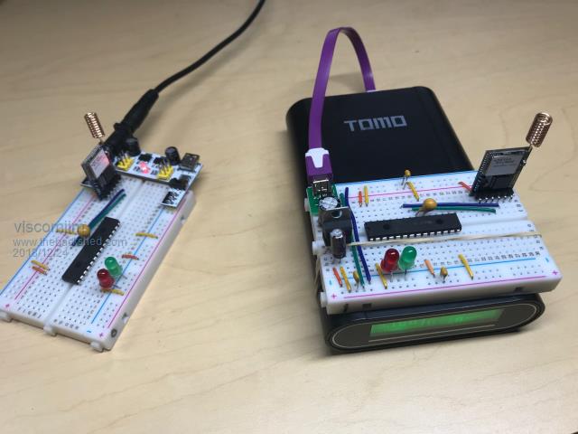

Picked up a couple of the Reyax Lora modules that work on 915Mhz for a project that would ideally get me 1.5 miles of distance between two warehouses at work. Set them up on two different breadboards with micromites controlling them. They conveniently work on 3.3v and use a simple AT command set. At full transmit power they use 43ma. After a bit of playing, I got them to play Ping Pong with each other and was able to use Geoffs brilliant RX serial interrupt on character function. (WORKS GREAT, Thanks!)
They seem to take a bit of time to communicate with each other which I find strange, but this is probably how they work to get the crazy distances??? I have one unit (base) that sends out "HELLO" and when the other unit (remote) receives that successfully, it sends back "ACK". If the base unit receives that successfully it starts the process over again. If the base doesn't receive the ACK within 3 seconds, it tries again. Without using any delays, the complete round trip takes about 1800 ms.
I have only done a quick walk around the neighborhood with the remote unit on a usb battery bank and am TOTALLY amazed at how far these go. This is not line if site, but through houses, trees, etc. Once I get a bit of time, I will add a gps unit on the remote and do some real distance testing, but so far so good. I have not gotten a great handle on these yet, but for sending packets of data to control things or receiving data from remote sensors, this might be a great way to do this.

I hope everyone has a great holiday season, and a big thanks to Geoff and Matherp and ALL the members of TBS that keep me off the streets with all the micromite goodies that consume my time.Edited by viscomjim 2018-12-25
