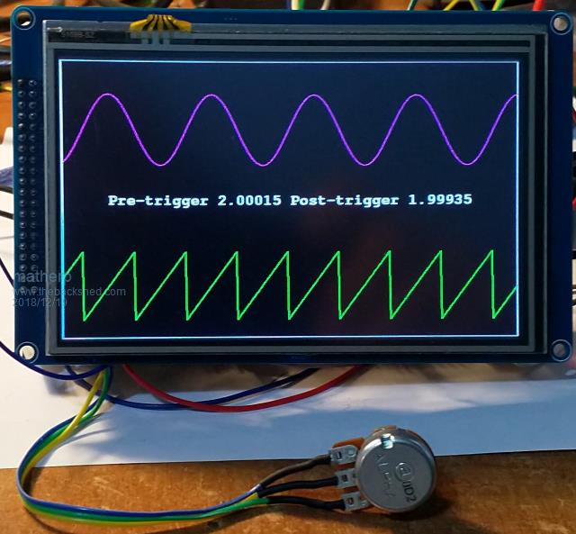

Quite pleased with this one.
2018-12-19_054119_Armmite1.3.zip
It implements new ADC functionality that can capture up to 3 channels of data in the background at up to 500KHz per channel with user selectable triggering - ideal for zero-crossing detection or similar.
The functionality is all driven by the new command ADC
To enable the ADCs use the command
ADC OPEN frequency, channel1-pin [,channel2-pin] [,channel3-pin] [, interrupt]
"frequency" is the sampling frequency in Hz. The maximum frequency is 500KHz.
From 320KHz to 500KHz the conversion is 8-bits per channel
From 160KHz to 320KHz the conversion is 10-bits per channel
From 80KHz to 160KHz the conversion is 12-bits per channel
From 40KHz to 80KHz the conversion is 14-bits per channel
Below 40KHz conversion is 16-bits per channel
This is automatically compensated for in the firmware.
"channel1-pin" can be one of 34, 35, 36, 37, 42, 43, 44, 45, 46, 47, 49, 50
"channel2-pin" can be one of 13, 14, 15, 18, 19, 21, 22, 26, 27, 28, 29
"channel3-pin" can be one of 53, 54
The "interrupt" parameter is a normal MMBasic subroutine that can be called when the conversion completes.
The ADC is started using the command
ADC START channel1array!() [,channel2array!()] [,channel3array!()]
The floating point arrays must be the same size and the size will determine the number of samples.
Once the start command is issued the ADC(s) will start converting the input signals into the arrays at the frequency specified.
If the OPEN command includes an interrupt then the command is non-blocking. If an interrupt is not specified the command is blocking.
The samples are returned as floating point values between 0 and VCC. VCC is assumed to be 3.3V but this can be altered using the command "OPTION VCC voltage". This option is reset on reboot.
The ADCs can be disabled with the command
ADC CLOSE
After the OPEN command has been issued the frequency can be adjusted using the command
ADC FREQUENCY frequency
This command is only allowed if the number of bits calculated in the table above does not change otherwise it will give an error.
The new firmware also supports ADC triggering using the command
ADC TRIGGER channel, level
This should be specified before the ADC START command.
The "channel" can be a number between one and three depending on the number of pins specified in the ADC OPEN command.
The level can be between -VCC and VCC.
A positive number indicates that you are looking for a positive going transition through the specified voltage.
A negative number indicates that you are looking for a negative going transition through the specified voltage (as in the example).
Option explicit
Option default none
Option VCC 3.309
Dim integer i, j
CLS
' First set up some signals using the onboard DAC
' connect pin 40 to pin 49 and pin 41 to pin 22
' connect a potentiometer to pin 53 to use as a trigger
Dim a(799) As float, b(799) As float, t(799) As float, c%(179), d%(179)
For i=0 To 179
c%(i)=Sin(Rad(i*2))*1500+2048
d%(i)=i*2000/180+2048
Next i%
DAC start 100000,c%(),d%()
ADC open 100000,49,22,53,adc_done
ADC trigger 3,-2.0 ' specify the potentiometer channel to use to trigger with a negative slope through 2.0V
ADC start a(), b(), t()
Loop While j=0
Box 0,0,MM.HRes,MM.VRes
Pixel 0, 200-a(0)*50, RGB(magenta)
Pixel 0, 470-b(0)*50, RGB(green)
For i=1 To 799
Line i-1,200-a(i-1)*50 , i, 200-a(i)*50 , 1, RGB(magenta)
Line i-1,470-b(i-1)*50 , i, 470-b(i)*50 , 1, RGB(green)
Next i
Text MM.HRes\2,MM.VRes\2,"Pre-trigger "+Str$(t(0),1,5)+" Post-trigger "+Str$(t(1),1,5),CM,4
End
Sub adc_done
j=1
End Sub

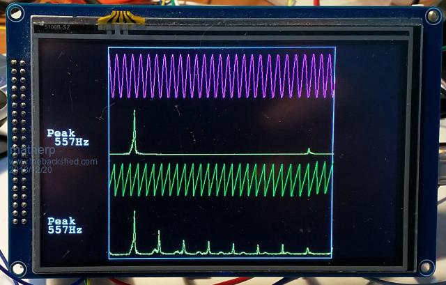

This now includes an FFT command to allow you do do frequency analyses of signals
The basic command FFT has the following syntax:
FFT signalarray!(),FFTarray!()
"signalarray" must be floating point and the size must be a power of 2 (e.g. s(1023) assuming OPTION BASE is zero)
"FFTarray" must be floating point and have dimension 2*N where N is the same as the signal array (e.g. f(1,1023) assuming OPTION BASE is zero)
The command will return the FFT as complex numbers with the real part in f(0,n) and the imaginary part in f(1,n)
The inverse command has the syntax:
FFT INVERSE FFTarray!(), signalarray!()
"FFTarray" must be floating point and have dimension 2*N where N must be a power of 2 (e.g. f(1,1023) assuming OPTION BASE is zero) with the real part in f(0,n) and the imaginary part in f(1,n)
"signalarray" must be floating point and the single dimension must be the same as the FFT array
The command will return the real part of the inverse transform in "signalarray"
Most useful is probably the magnitude command
FFT MAGNITUDE signalarray!(),magnitudearray!()
"magnitudearray" must be floating point and the size must be the same as the signal array
The command will return the magnitude of the signal at various frequencies according to the formula:
frequency at array position N = N * sample_frequency / number_of_samples
so if the sample frequency is 10KHz and there are 1024 samples then the frequency associate with the magnitude at "magnitudearray(57)" = 57 * 10000 / 1024 = 557HZ as in the example above
NB only the first N/2 values are useful as values after N/2 are beyond the Nyquist frequency and contain no useful information.
The final FFT command returns the phase angle at each frequency
FFT PHASE signalarray!(),phasearray!()
"phasearray" must be floating point and the size must be the same as the signal array
The command will return the phase angle of the signal at various frequencies according to the formula above.
The test code I used for the picture is:
