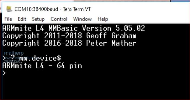

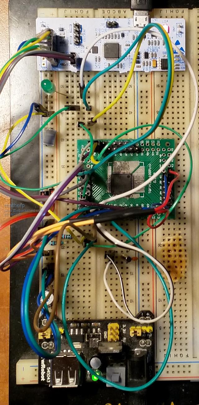

Please find attached version 5.05.02. This now includes support for 64 pin variants, the STM32L433RCT6 and the STM32L431RCT6 as well as 48 pin and 32 pin. The software automatically configures for the number of pins. I've done the development on a STM32L431RCT6 on a breakout (pic below) but the code should run well on a NUCLEO-L433RC. With all the STM32L4 the mandatory connections are:
all VSS and VCC including VSSA and VDDA, each pair decoupled close to the chip with 0.1uF ceramic caps
BOOT0 10K to GND
NRST 10K to VCC and direct to ST-LINK
Console TX and RX to USB/UART (or ST-LINK)
SWDIO and SWCLK to ST-LINK for programming
32KHz crystal to OSC32-IN and OSC32-OUT with 6pF caps to GND - NB this is essential for the firmware to run
VBAT (N/A for 32-pin) to VCC or to 3V battery

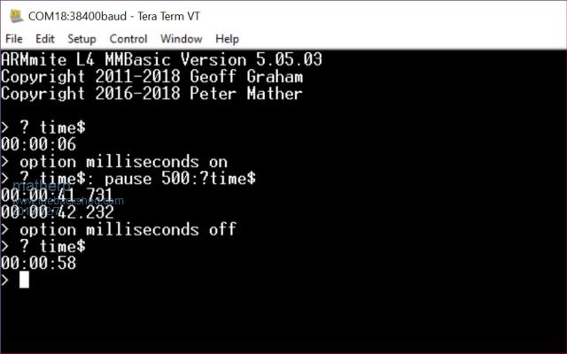

Posted: 09:58am 07 Dec 2018
Minor update that now allows the RTC to be read at millisecond resolution
2018-12-07_211451_ArmmiteL4.zip
I'll also include this functionality on the Armmite H7 next release.

I found an 'anomaly' with the millisecond time.
  Quote   OPTION milliseconds OFF
timeout
DO
t$=
TIME$
LOOP UNTIL RIGHT$(t$,1) = "0"
OPTION milliseconds ON
SETTICK 10000, timeout
timeout
DO
LOOP
SUB timeout
PRINT " ";TIME$;" ";DATE$
END SUB
produces this output:
> RUN
10:42:06 08-12-2018
10:42:10.001 08-12-2018
10:42:19.1000 08-12-2018
10:42:29.999 08-12-2018
10:42:39.998 08-12-2018
10:42:49.997 08-12-2018
> RUN
12:16:01 08-12-2018
12:16:10.001 08-12-2018
12:16:19.1000 08-12-2018
12:16:29.1000 08-12-2018
12:16:39.999 08-12-2018
12:16:49.997 08-12-2018
12:16:59.996 08-12-2018
The problem is when the time has zero milliseconds.
19.1000 rather than 20.000
Is it working at a higher resolution behind the scenes and 1000mS is really 999.9?
I did another run and this time one of the outputs was correct
> RUN
13:54:05 08-12-2018
13:54:10.001 08-12-2018
13:54:20.000 08-12-2018
13:54:29.1000 08-12-2018
13:54:39.999 08-12-2018
Edited by TassyJim 2018-12-09
Posted: 08:37am 08 Dec 2018
  Quote  I found an 'anomaly' with the millisecond time.
Very interesting. The issue is that the time in seconds, minutes, hours is latched in the RTC so you always get consistency. The milliseconds are based on a free running register that counts down from 4095 to zero each second. So it seems the register can be at zero but the main "time" has not yet latched in the change of seconds. I'll have to put in some sort of software "frig" to correct this - not sure what though. I certainly don't want to have to write a complete calendar function to deal with seconds/minutes/hours/... rollover
Posted: 08:51am 08 Dec 2018
  matherp said   I'll have to put in some sort of software "frig" to correct this - not sure what though.
A crude 'round down'
IF milliseconds >= 1000 THEN milliseconds = 999
Posted: 09:02am 08 Dec 2018
  Quote  A crude 'round down'
No, too nasty
Try this:
2018-12-08_195738_ArmmiteL4.zip
Here is my test program
CPU 8
Option milliseconds off
a$=Time$
Loop Until a$<> Time$
Option milliseconds on
Pause 990
Pause 999
Print Time$
Loop
Edited by matherp 2018-12-09

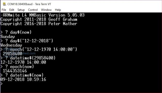

Posted: 02:29am 09 Dec 2018
More problems
I was going to ask if we can have negative EPOCHs because I was born before 1/1/1970.
I have found that it doesn't like dates last century.
> print epoch("08-04-1972 00:00:00")
Error: Invalid date
> print epoch("01-01-1970 00:00:00")
Error: Invalid date
> print epoch("01-01-2070 00:00:00")
3155760000
Posted: 08:30am 09 Dec 2018
I just used Geoff's standard parsing for the "DATE$" command
if(d < 1 || d > 31 || m < 1 || m > 12 || y < 2000 || y > 2999) error("Invalid date");
but that is easily fixed.
2018-12-09_205542_ArmmiteL4.zip
The linux time routines that I use don't work before 1970 (it wasn't invented by then) - sorry
NB I've also changed the format of the DAY$ function as per a change I've just made on the Pi-cromite
Edited by matherp 2018-12-10
Posted: 12:43pm 09 Dec 2018
Just for you, I've found some different time routines so EPOCH and DATETIME$ now work back to 1902 with epoch going negative before 1970.
2018-12-09_225751_ArmmiteL4.zip Edited by matherp 2018-12-10
