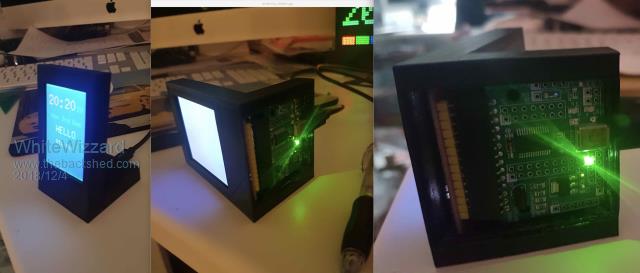

Got me an AnyCubic i3 Mega (thanks to Malibu's TBS post a while ago) and absolutely love it.
Printed out some nice 2.8 ILI enclosures. Was about to finish another design when I ran in to my current issue.
Will post pictures soon as I think people here may love it for their 2.8 BackPack modules

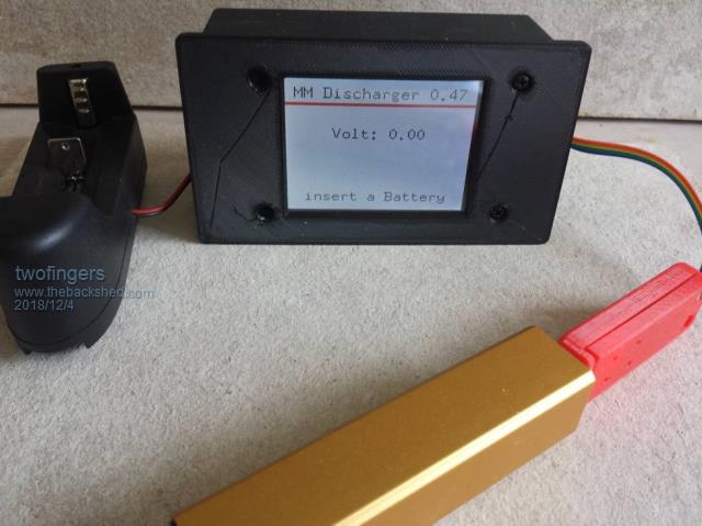

2.8 ILI enclosures
I made my enclosure for Micks 170 BP () and 2.4" and 2.8" LCDs.
I ceated also a case for the "nacked" Serial to USB Adaptors (cp2102).

I too use Big Mik's BP (SMD). Got a 'poor' pictures here (they really don't do justice) . . .

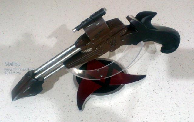

Here's a printed model I did for a mate as a 2nd print (after the factory release owls as a trial, of course!)
Any Trek fans will recognise it
Around 450mm long, it's all completely printed except for the 'barrels' and the curved part of the stand... All in good fun, but it was a learning curve!
