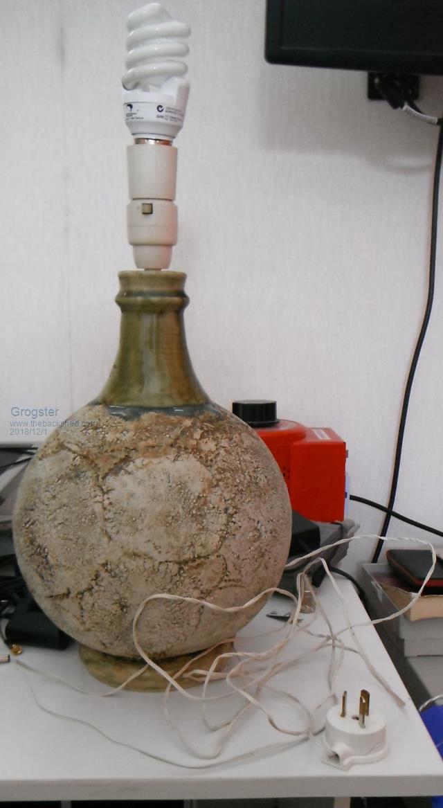

This is interesting. 230v lamp wired up with low-voltage bell-wire.

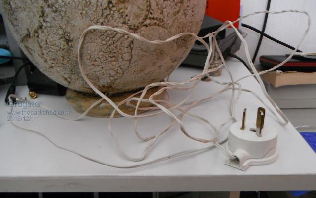

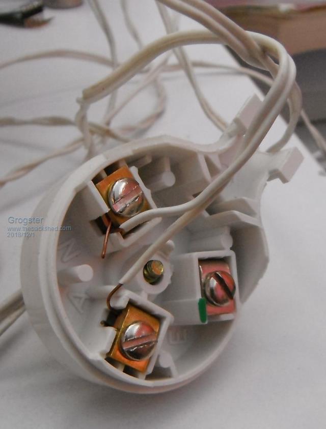

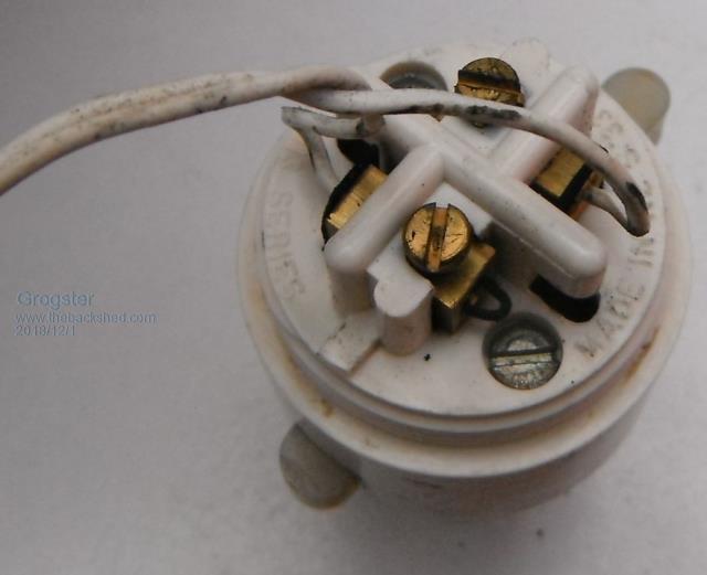

This is the solid-core wire often used to wire up door bells to the outside buttons. Normally only used with 6v or so, generally no more then about 12v. Note that the wire used for phase is not even clamped in the plug terminal.....
The customer called me in to look at the lamp, as they had to bang the lamp or wiggle the power cord to make it work. I wonder why?! (rhetorical)
I pointed out(gently) when I saw this, that it is totally illegal wiring, potentially dangerous and a possible fire-risk wired up with bell-wire as it is.

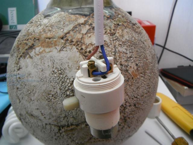

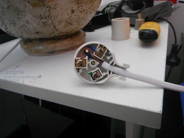

Luckily, they agreed to my taking the lamp back to my workshop and to replace the mains cable with approved cable to restore it's electrical safety.
But jobs like this do scare me a little. I wonder how long it had been wired up like that, and to think that there are probably thousands of things wired up like that by enthusiastic amateurs.

  Boppa said  But bell wire?? that stuff snaps just by looking at it too hard, possibly leaving you with a bare wire sticking out...
Ugghhhhh
Yeah, take a look at all the horrible twists in that wire in the photos. Not good.....

I actually used the bell-wire as a draw-wire to pull the new 2-core flex through the lamp. That saved a lot of fiddling about, so it was useful for THAT!
