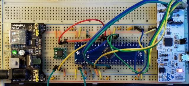

Please find attached version 5.05.01 which supports both 32-pin and 48-pin parts.
2018-11-30_230951_ArmmiteL4.zip
This is tested on a STM32L433CCT6 but will also run on STM32L431CCT6. The chip is mounted on an Adafruit 48-pin LQFP adapter . The chips are 0.5mm pitch so pretty easy to solder. I haven't tested all pin functionality but all MMBasic functionality works fine as does the SPI flash file system.
Pinout for the 48-pin chips is:

Hi matherp
I'm trying to work your firmware with a my old PCB for stm32l4x 48pin and STM32L431.
I have all the fundamentals pins connected with caps, res and crystal.
If try my simple firmware ports, uart, timer the micro works.
But If I try to put your firmware the micro seems blocked.
Apart boot0, nrst, do I need to take some precautions?
AntonioEdited by sagt3k 2019-03-20
Posted: 01:22pm 19 Mar 2019
From the manual which is nearing completion finally.
  Quote  Connect GND to pins 8, 23, 35, and 47
Connect 3.3V to pins 9, 24, 36, and 48
Tie BOOT0 (pin 44) to GND with a 10K resistor
Connect a low capacitance (12pf maximum) 32768Hz crystal between pins 3 and 4. Decouple both pins to GND with 12pf capacitors
Tie NRST (pin 7) to 3.3V with a 10K resistor
Decouple the 3.3V supply with 0.1uF capacitors close to pins 8 & 9, 23 & 24, 35 & 36, 47 & 48
Connect a USB/UART TX pin to STM32L4 pin 13
Connect a USB/UART RX pin to STM32L4 pin 12
Connect a USB/UART GND pin to GND
Connect VBAT (pin 1) to 3.3V or to a 3V battery which has a common ground with the rest of the circuit. Using a battery will keep the RTC accurate even if the rest of the circuit is powered off
The other thing worth trying is to disconnect the ST-LINK to make sure it isn't holding NRST.
Is your chip definitely a CC and not a CB? The CB is only 128K flash. The firmware would probably load but can't run.

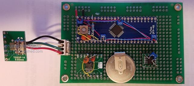

grumpyoldgeek
Joined: 30/07/2018
Posts: 58
Posted: 06:58am 26 Apr 2019
Matherp,
Using the above design with the 32khz crystal, can the firmware be loaded through the serial port if BOOT0 is pulled up?

Thanks. I've been trying to build a prototype similar to what you've done, but I don't see a waveform on the crystal terminals. I've double checked the wiring and tried 2 crystals and a ceramic resonator and I still get nothing. I'll try a new cpu next.

Posted: 12:32am 01 May 2019
Peter,
The ARMmite L4 manual says to ground pin 3 of the W25Q128JV flash memory chip. The datasheet for the part shows pin 3 grounded to write protect the part. Is this an error, or are you using a register inside the part to enable writes?
I also noticed in the STM32L433 datasheet that the NRST pin has an internal weak pullup, so a 10k pullup is probably unnecessary if the pin is not used otherwise.
I have everything working except the flash memory, which I have not connected yet. I spent a lot of time thinking my prototype was not working because I could not see any signals on the oscillator pins. It turns out that the unprogrammed part uses the internal oscillator and there is no signals on the pins until code turns on the oscillator.

grumpyoldgeek
Joined: 30/07/2018
Posts: 58
Posted: 03:36am 02 May 2019
Prototype is fully functional. A couple of notes, pin 2 on the L433 does not work for flash chip select, I ended up using pin 5. 32khz crystal is only active after loading firmware. When active, you should see a rough sine wave on pins 3 & 4 of about 120 millivolts. DO NOT waste your time trying to get the STM Serial Loader Demo to work, use the STMCube Programmer as the documentation says. It works great. Schematics will follow in a few days.

grumpyoldgeek
Joined: 30/07/2018
Posts: 58
Posted: 11:14pm 02 May 2019
I'm seeing a VBAT current draw of about 60 microamperes when VDD is removed. Is that normal? I need something closer to 2-3 microamperes for a coin cell.

grumpyoldgeek
Joined: 30/07/2018
Posts: 58
Posted: 06:14pm 03 May 2019
Peter,
I'm still having problems with VBAT current consumption. I've loaded firmware 2019-03019 and the processor behaves correctly in all other respects. I removed all components from the processor to insure that there are no sneak paths for parasitic current draw. All that is connected to it is the 32Khz crystal and its capacitors and a high quality meter capable of measuring tenths of micro-amperes which is in series with the coin cell and the VBAT pin. The circuit board has been meticulously cleaned.
I connect a coin cell to VBAT and apply 3.3 volts to Vdd. The processor works fine and the 32Khz oscillator is running. VBAT current is zero.
I remove the 3.3 volts and VBAT current is 0.3 micro-amperes. The oscillator is running.
I reapply 3.3 volts and then remove it. VBAT current goes up to 60 micro-amperes. Subsequent cycling of Vdd does not improve things. Neither does resetting by momentarily grounding NRST. The only way to get VBAT back to 0.3 micro-amperes is to remove both VBAT and Vdd and reapply them.
Any help you can give would be appreciated. I'd be happy to replace the processor chip if you think that might help. Edited by grumpyoldgeek 2019-05-05
