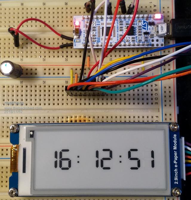

Watch the demo
MMbasic running on the NUCLEO-L432KC
dim s$
CLS
option autorefresh off
do
if time$<>s$ then
s$=time$
text mm.hres\2,mm.vres\2,s$,CMU,8,1
box mm.hres\2-8, 98,4,4,,1,1
box mm.hres\2+4, 98,4,4,,1,1
box mm.hres\2-8, 196,4,4,,1,1
box mm.hres\2+4, 196,4,4,,1,1
refresh
endif
loop

What is the purpose of the four BOX commands (at first I thought something to flash the second's colon).
Posts: 11894
Posted: 04:44pm 11 Nov 2018
  Quote  What is the purpose of the four BOX commands (at first I thought something to flash the second's colon).
The seven segment font doesn't have a colon symbol so these just mimic one

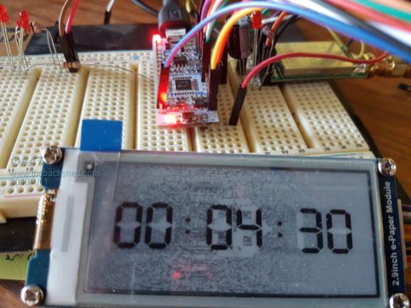

When I use the OPTION AUTOREFRESH OFF/REFRESH in 5.04.37 on ST-L4 and 2.9" e-Paper the screen goes to black before the update. Is there any way I can fix that?

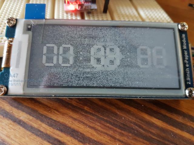

I am still a little confused as to how I can clear the e-ink display whilst connected to the L4 armmite. The display has random pixels still dark at the top of the display and all attempts to get the display back to white have not been successful. I have not been able to get CLS to function with this display and the L4.

Somthin' screwy going on at my end.
when I type CLS from prompt only the written area gets cleared.
Any suggestions anybody? I have tried option lcdpanel disable power down then up then option lcdpanel gdeh029a1 etc even tried to enable and disable each pixel on the screen.

At a guess I would say the display is faulty.

Just noticed looks like still have the peel off protective coating on the display? It is not causing some sort of static interference is it.
Have you tried the display on a Micromite.

@ Matherp, Peter, even using version 5.0435 my 2.9in display insists on flashing black every update.
Quite puzzling when you've shown us it doesn't need to!
Using option lcdpanel GDEH029A1, L, 15, 21, 14, 22, 1 and your clock program.
Do these displays vary between batches or something?
