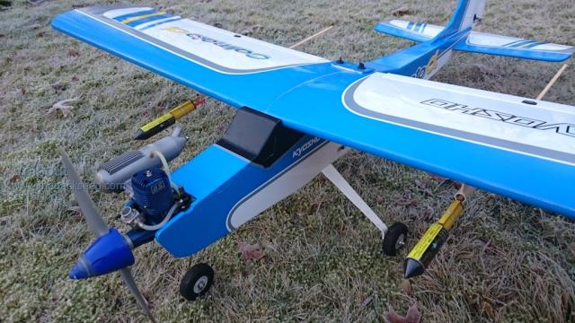

Flying RC airplanes is one of my hobbies. Electronics in RC airplanes is generally bought, since homebrew is far more expensive. But sometimes something pops up that makes it worth designing something yourself.
This forum is the heart of the micromite world, so this article might be a bit out of place here, but I wanted to share it anyway.
For my model aircraft I needed a remote controlled switch for aircraft lighting, and other functions.
The aircraft lights consist of 12V LED strips.
This switch allows 2 groups of LED's to be controlled independent.

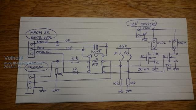

The switch uses an 08M2 to convert the PWM RC input signal and drive the power switches.
There are 2 jumpers in the circuit, that allow programming the switch detection levels (PWM level that turns on the particular switch).
Installation:
connect the circuit to the receiver channel (i.e. the GEAR switch)
put JP1 on (if there is a LED strip attached, it will light up if 12V is connected)
Turn on the receiver and transmitter in the required setting for this function.
The 08M2 will (after 1 second) start measuring the PWM , and store it in internal memory.
Repeat this for JP2 (remove JP1).
Remove both JP1 and JP2. The circuit is ready for use.

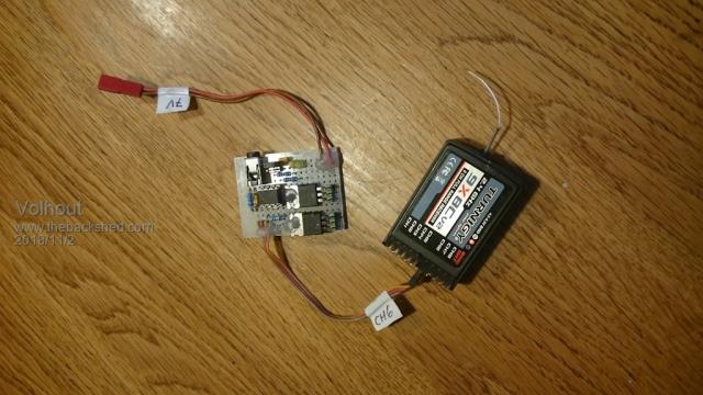

Attached are photo's of the prototype, and the circuit diagram.

The power FET's can switch significant current, more than needed for LED strips, to also cover other applications. One of such applications is the annual festival at our airport on new years day, where we have fireworks....launched from an RC controlled airplane.

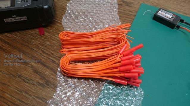

For those who like to know the igniters, they are from china, 50 pieces for USD 5.

Nice project, and thanks for sharing. Good documentation and clear code.
My only question would be about the use of the IRF744 Mosfets. In the datasheet, the "Typical Transfer Characteristics" chart shows about 5 amps at 5V VGS, Gate-to-Source Voltage (V) (which may be more than adequate for your purposes).
A "logic-level" mosfet like the IRLZ44N will allow much more current for 5V VGS.
RDS-On for the IRF744 is .63 Ohms (at 10V VGS); for the IRLZ44N, .025 Ohms at 5V, 25A. (Other mosfets will have even better characteristics for critical circumstances.)

Can you link us to where you got the igniters from?

  Grogster said   Can you link us to where you got the igniters from?
Google is your best friend. They can be found in a variety of prices and wire length on
Ebay
Alibaba
Amazon
They typically fire around 3 volts, and contain magnesium, so they burn bright.
There are 2 ways of using them.
1 remove the protective top and insert directly into the firework.
2 fireworks that have a fuse, cut short the fuse and use the protective top to keet fuse and igniter pressed together. This gives a delay of roughly one second if the fuse is cut very short.
Success....
About the fets, yes better fets can be selected. This is what I had in the box.
If I would bring this out commercially I would sure go for SMT parts with logic levels.Edited by Volhout 2018-11-05
