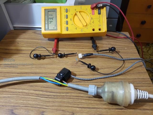

Here is my test setup
Here I have it hooked up to my oil heater the label says 2000w so that looks about right (see page two of datasheet above) at say 8amps.
Now the pump reads 10.3 mV so that's about 2amps
The pump label says 1.48kW (say 6amps?) max of course.

You could TRY to read that with a MM just for the purposes of experimentation, but they are TINY voltages, and would be rather prone to background noise etc. Especially if you plan to cable that tiny voltage to your MM - that probably won't work for the reasons stated by Mik.
You're talking MovingMagnet record player cartridge or guitar pickup levels here.
It's still do-able, but you will need some kind of amplifier for the output of the CT, before you cable to your MM. This could be as easy as an op-amp with a gain of 10 or so.
I suggest you use a module such as this for three bucks. It has the CT and the op-amp voltage booster on-board for you, and an adjustable output voltage. Set it up, and job done. Even via some cable to the MM.
Or there is this slightly more expensive module which can output a serial datastream to your MM's COM port, and you just read the data.
