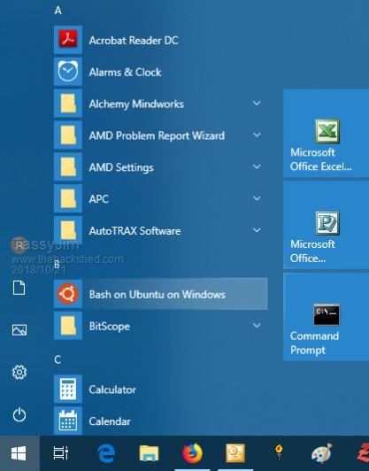

Why stop at grep.
Bash:
You can get a lot more in Windows if you want a linux fix.
Compliments of Microsoft.
JimEdited by TassyJim 2018-10-22

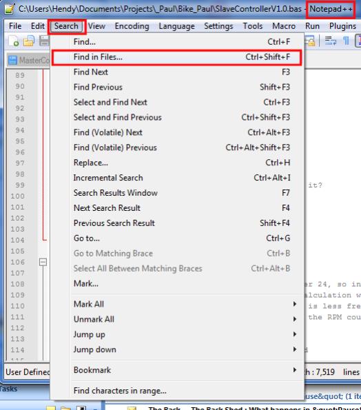

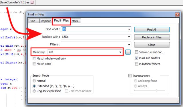

Notepad++ does this for you as well - very easy to use
Posted: 07:45am 21 Oct 2018
... what Peter said... and you don't have to step outside your editor.

@ matherp and CaptainBoing - Thanks. I knew of Notepad++, but was unaware it could do that, so that is useful information to have.

Captain,
I also notice you are using some language formatting & folding in the images.
Have you worked on a custom one, or is that one of the built-ins?
Played with that a few years back, but had a few issues left unfinished.
Phil

I think I got it from here so it could well be yours. I refined it a bit, its still not perfect but I got it to a stage where it is usable and the bits that are broken don't bother me. here is the XML...
<NotepadPlus>
<UserLang name="MMbasicH" ext="bas" udlVersion="2.1">
<Settings>
<Global caseIgnored="yes" allowFoldOfComments="no" foldCompact="no" forcePureLC="0" decimalSeparator="0" />
<Prefix Keywords1="no" Keywords2="no" Keywords3="no" Keywords4="no" Keywords5="no" Keywords6="no" Keywords7="no" Keywords8="no" />
</Settings>
<KeywordLists>
<Keywords name="Comments">00' 01 02 03 04</Keywords>
<Keywords name="Numbers, prefix1">&H</Keywords>
<Keywords name="Numbers, prefix2">&H 0 1 2 3 4 5 6 7 8 9 A B C D E F</Keywords>
<Keywords name="Numbers, extras1">A B C D E F</Keywords>
<Keywords name="Numbers, extras2"></Keywords>
<Keywords name="Numbers, suffix1"></Keywords>
<Keywords name="Numbers, suffix2"></Keywords>
<Keywords name="Numbers, range"></Keywords>
<Keywords name="Operators1">= * / + - < <= =< > >= => , ( )</Keywords>
<Keywords name="Operators2">,</Keywords>
<Keywords name="Folders in code1, open"></Keywords>
<Keywords name="Folders in code1, middle"></Keywords>
<Keywords name="Folders in code1, close"></Keywords>
<Keywords name="Folders in code2, open">"Sub" "Function" "Select Case"</Keywords>
<Keywords name="Folders in code2, middle">"Exit Sub"</Keywords>
<Keywords name="Folders in code2, close">"End Sub" "End Function" "End Select"</Keywords>
<Keywords name="Folders in comment, open"></Keywords>
<Keywords name="Folders in comment, middle"></Keywords>
<Keywords name="Folders in comment, close"></Keywords>
<Keywords name="Keywords1">option dim include abort abs abs( ain and as asc asc( atn atn( autorun autosave base baudrate bin$ bin$( bitmap black blue box brown byte case cfunaddr cfunction chr$ chr$( cin cint cint( circle clear clocktrim close cls cmd color colour const continue cos cos( cpu csub cyan data date date$ default definefont deg deg( delete dht22 dim din distance do dout ds18b20 ds18b20( echo edit else elseif end endif eof eof( erase error exit exp exp( explicit fc fin fix fix( float font for function gettime gosub goto gray green gui hex$ hex$( humid i2c if init inkey$ input input$ input$( instr instr( int int( intb integer inth intl invert ir ireturn is keypad lcase$ lcase$( lcd lcdpanel left$ left$( len len( length let library line list loc loc( local lof lof( log log( loop magenta memory mid$ mid$( min min( max max( mm.device mm.device$ mm.hres mm.i2c mm.onewire mm.ver mm.vres mm.watchdog mod new next noecho noinvert not oc oct oct$ oct$( off on onewire open option or pause peek peek( pi pin pin( pixel poke port port( pos print progmem prompt pulldown pullup pulse pulsin pwm rad rad( randomize rbox read receive red rem restore return rgb right$ right$( rnd rnd( rtc run save select send servo setpin settick settime sgn sgn( sin sin( skip slave sleep space$ space$( spc spc( spi spi( sqr sqr( step stop str$ str$( string$ string$( sub tab tab( tan tan( tempr text then time$ timer to touch touch( trace troff tron ucase$ ucase$( until val val( var varaddr vartbl watchdog wend while white word write xmodem xor xor yellow </Keywords>
<Keywords name="Keywords2"></Keywords>
<Keywords name="Keywords3"></Keywords>
<Keywords name="Keywords4"></Keywords>
<Keywords name="Keywords5"></Keywords>
<Keywords name="Keywords6"></Keywords>
<Keywords name="Keywords7"></Keywords>
<Keywords name="Keywords8"></Keywords>
<Keywords name="Delimiters">00" 01 02" 03 04 05 06 07 08 09 10 11 12 13 14 15 16 17 18 19 20 21 22 23</Keywords>
</KeywordLists>
<Styles>
<WordsStyle name="DEFAULT" fgColor="000000" bgColor="FFFFFF" fontName="" fontStyle="0" nesting="0" />
<WordsStyle name="COMMENTS" fgColor="00aa00" bgColor="FFFFFF" fontName="" fontStyle="0" nesting="0" />
<WordsStyle name="LINE COMMENTS" fgColor="808080" bgColor="FFFFFF" fontName="" fontStyle="0" nesting="0" />
<WordsStyle name="NUMBERS" fgColor="FF0000" bgColor="FFFFFF" fontName="" fontStyle="0" nesting="0" />
<WordsStyle name="KEYWORDS1" fgColor="0000FF" bgColor="FFFFFF" fontName="" fontStyle="0" nesting="0" />
<WordsStyle name="KEYWORDS2" fgColor="0000FF" bgColor="FFFFFF" fontName="" fontStyle="0" nesting="0" />
<WordsStyle name="KEYWORDS3" fgColor="0000FF" bgColor="FFFFFF" fontName="" fontStyle="0" nesting="0" />
<WordsStyle name="KEYWORDS4" fgColor="0000FF" bgColor="FFFFFF" fontName="" fontStyle="0" nesting="0" />
<WordsStyle name="KEYWORDS5" fgColor="0000FF" bgColor="FFFFFF" fontName="" fontStyle="0" nesting="0" />
<WordsStyle name="KEYWORDS6" fgColor="0000FF" bgColor="FFFFFF" fontName="" fontStyle="0" nesting="0" />
<WordsStyle name="KEYWORDS7" fgColor="0000FF" bgColor="FFFFFF" fontName="" fontStyle="0" nesting="0" />
<WordsStyle name="KEYWORDS8" fgColor="0000FF" bgColor="FFFFFF" fontName="" fontStyle="0" nesting="0" />
<WordsStyle name="OPERATORS" fgColor="666666" bgColor="FFFFFF" fontName="" fontStyle="0" nesting="0" />
<WordsStyle name="FOLDER IN CODE1" fgColor="000000" bgColor="FFFFFF" fontName="" fontStyle="0" nesting="0" />
<WordsStyle name="FOLDER IN CODE2" fgColor="0000FF" bgColor="FFFFFF" fontName="" fontStyle="0" nesting="0" />
<WordsStyle name="FOLDER IN COMMENT" fgColor="000000" bgColor="FFFFFF" fontName="" fontStyle="0" nesting="0" />
<WordsStyle name="DELIMITERS1" fgColor="00aa00" bgColor="FFFFFF" fontName="" fontStyle="0" nesting="0" />
<WordsStyle name="DELIMITERS2" fgColor="FF0000" bgColor="FFFFFF" fontName="" fontStyle="0" nesting="0" />
<WordsStyle name="DELIMITERS3" fgColor="000000" bgColor="FFFFFF" fontName="" fontStyle="0" nesting="0" />
<WordsStyle name="DELIMITERS4" fgColor="000000" bgColor="FFFFFF" fontName="" fontStyle="0" nesting="0" />
<WordsStyle name="DELIMITERS5" fgColor="000000" bgColor="FFFFFF" fontName="" fontStyle="0" nesting="0" />
<WordsStyle name="DELIMITERS6" fgColor="000000" bgColor="FFFFFF" fontName="" fontStyle="0" nesting="0" />
<WordsStyle name="DELIMITERS7" fgColor="000000" bgColor="FFFFFF" fontName="" fontStyle="0" nesting="0" />
<WordsStyle name="DELIMITERS8" fgColor="000000" bgColor="FFFFFF" fontName="" fontStyle="0" nesting="0" />
</Styles>
</UserLang>
</NotepadPlus>
