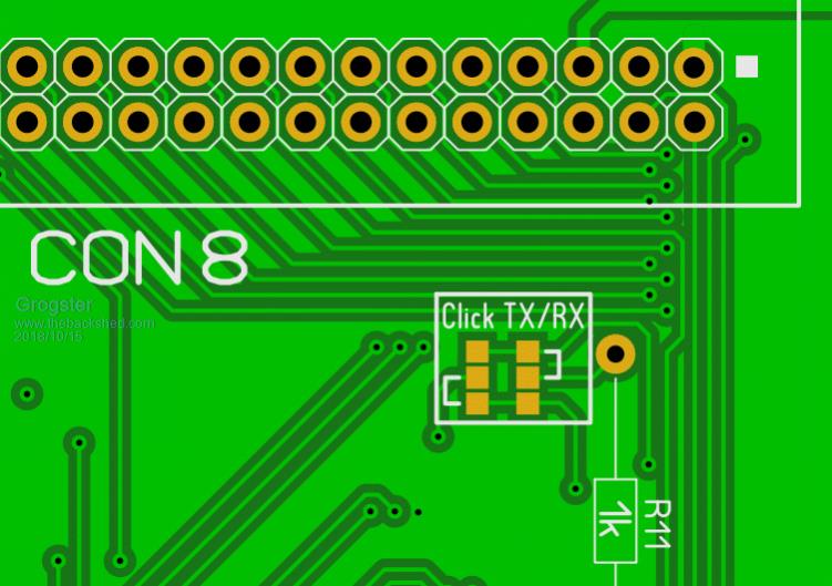

Over a year ago, I acquired a couple of E-100s and I populated both Click sockets.
One was an RS232 module and the other was the LS7366 quadrature encoder interface (SPI).
I remember having trouble getting something working and was about to consult this community when I came across another post that mentioned linking a couple of pads on the bottom of the board. I did this and my problem went away. I still don't see any mention of these pads on Geoff's site.
Can anyone please remind me of what they are... something to do with routing Rx and TX, maybe?
Posts: 10114
Posted: 06:19am 15 Oct 2018
I assume you mean these pads:
When the E100 was designed, there was no clarity on exactly which way the serial connection was. IE: On the Click modules, was TX in or out?
To cover this, we put the little pads to allow you to reverse the serial TXD and RXD if that ever proved to be necessary.
The silkscreen shows the way we(Geoff and I) thought it should be, but you could solder-blob the middle and other pads to reverse the serial connections.
This does not seem to have been necessary, as it would appear our original interpretation was correct, and normally, all you need to do, is solder-blob to the two pads as indicated to route the serial port to the CLICK sockets.

Posted: 07:04am 15 Oct 2018
Yeah,that was it... many thanks
