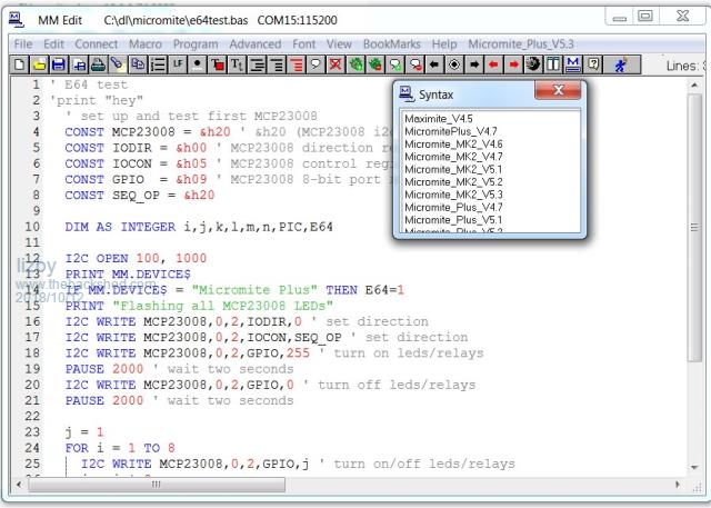

One snag along the way--when I click on the version-choosing item to the right of "Help", I can only see some of the options, and see no way to scroll. I clicked the bottom option, clicked the chosen item again, hit the down arrow, which chose the next, invisible option, and then repeated that until I got to Micromite_Plus_V5.3.

The list should have a scroll bar.
If your mouse has a scroll wheel, it should scroll the list for you.
What version of Windows are you running and do you have any scale set other than 100%?
Posted: 12:13pm 12 Oct 2018
Windows 7 on a laptop--no scroll wheel. I'm not sure what scale you would mean--other than for certain browser windows, I don't know that I have any scales set.

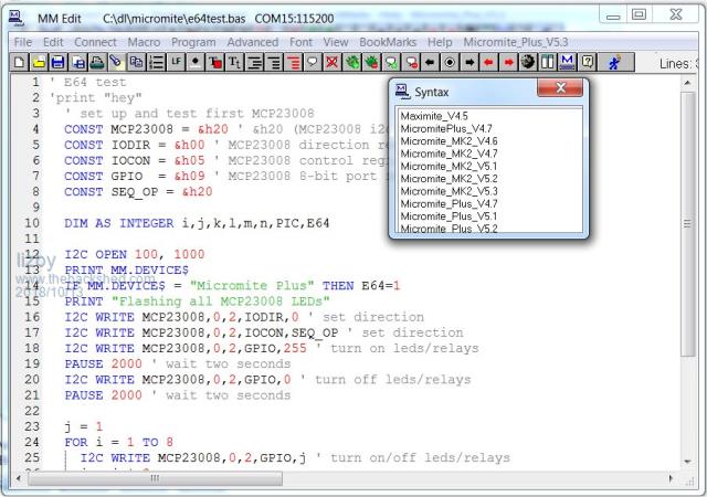

Try this TKN file. Replace the one in the program folder. It will make the pop-up a bit wider and will hopefully show the scrollbar.
The problem is caused by the different sizes of the borders around the windows.
2018-10-13_071113_MMedit.zip

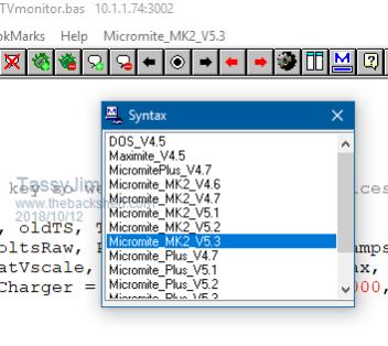

Post a screenshot of the pop-up please.
If your display is high resolution you might have it set to display text at 125% or 150%. That can cause issues but I don't think that is the problem here.
Posted: 11:51pm 12 Oct 2018
With new TKN file, the pop-up appears slightly wider than before, but no scroll bar.
Screen resolution is maximum available on my laptop, 1600x900.

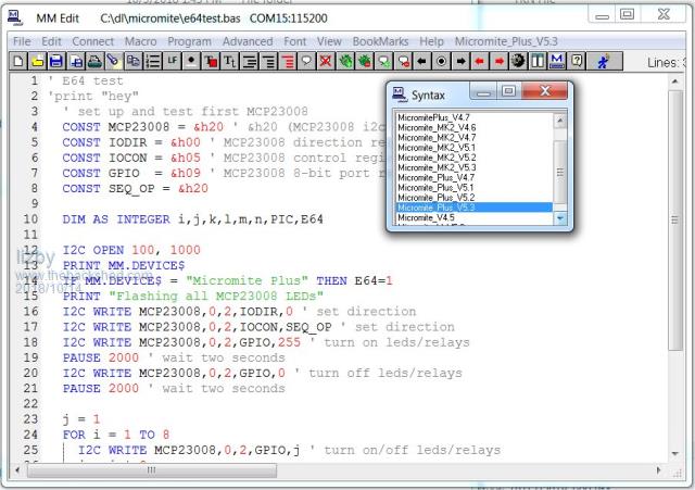

Posted: 02:23am 13 Oct 2018
OK one more try.
With a display of 16090 pixels you either use a magnifying glass to see the menus in MMEdit or your display settings are set to 125 or 150%
That way all the programs that call for 100 pixels actually display over 125 or 150 pixels.
The way Windows does it really sucks and it changes from year to year.
I don't have Windows7 anymore so I can't tell you how to find the display settings.
The language that MMEdit is written in doesn't know much about DPI scaling so it is difficult for me to control it.
It looks like Windows scales the pop-up window differently to the control inside the pop-up, causing it to not fit.
This TKN has sizing controls on the pop-up so you should be able to size it to fit the full control, complete with scrollbar.
2018-10-13_122138_MMedit.zip
A screenshot with the pop-up sized will help me set it for you.
I can't leave the sizing controls on it unfortunately.
Posted: 02:44pm 13 Oct 2018
That did it. Scroll bar appeared without my doing anything. Thanks.
