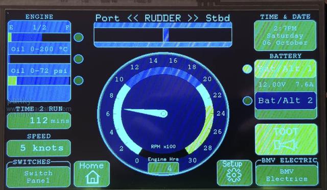

Yes, I do understand the current limit of 8", however checking the specs of the 7", 8" and 9" panels, they all are 800 x 480, all use the SSD1963 and XPT2046.
Looking at the example code for use with Arduino, they all appear to have very similar setups with some minor variations on timing which I assume is just related to physical size. The only major difference is the pinout but I have that worked out and flying leads across to an Explore 100.
So I took the chance to have a play around and try to get it to work
The fact that the display is completely stable with complex text and GUI elements displayed would indicate that in genereral, it is 99% compatible - the only issue is colour and in fact it is red that is missing although I do get some white (ish) elements displayed. I have tried varying combos of colour using the CLS command but most turn out to blue through green. Could be timing related to passing colour info?
Screenshot is as shown below
Ignore the striations - they are an artifact introduced by the camera. All colours, while wrong in colour are solid blocks and bright and clear. The needle in the circular gauge should be gray but comes up as off white with a blue tinge. The blue in the centre of the gauge should be darkish gray as should the background on the engine frame and so on and so forth.
panky.

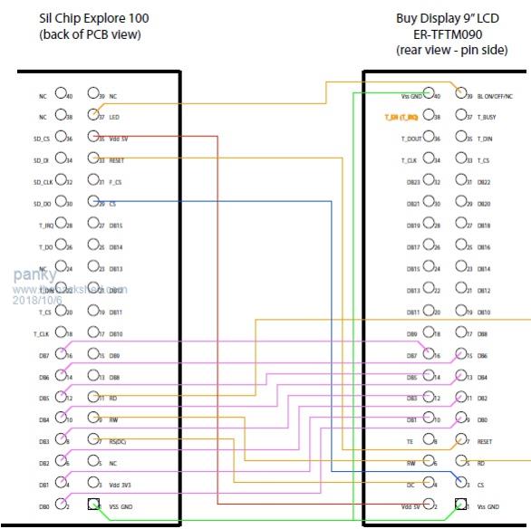

I can report that the 9" TFT LCD from BuyDisplay.com part number
ER-TFTM090 v10
9"-800xRGBx480 Dots TFT LCD Module with SSD1963 and Touch Controller XPT2046
works straight out of the box using
OPTION LCDPANEL SSD1963_8,l,48,6
(the last two numbers are for my Explore 100 that I am driving it with).
Diagram of the pinout as below
panky

Good experience all around. I am now working on an adaptor board that will connect to the 7" header and re-map to a header for the 9". Have not had a chance to test on MMX or ARMMite platforms yet but hope to get to that over the next few weeks.

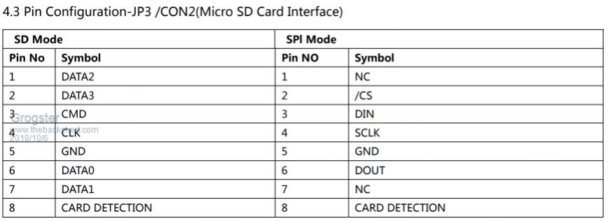

Forgot to add, SD card on the LCD is a 4 bit paralled and I understand this is not supported so if you need an SD card and want to use this unit, you will need one on the main PCB like Grogsters 1D Explore 100 board.
panky.
Posted: 07:26am 06 Oct 2018
  Quote  SD card on the LCD is a 4 bit paralled and I understand this is not supported
You should still be able to use it in SPI mode

I might just have to check these ones out. I assume these are the ones you got:
9" LCD LINK
EDIT:
@ panky: From 9" PDF manual for this display, page 10, section 4.3:
