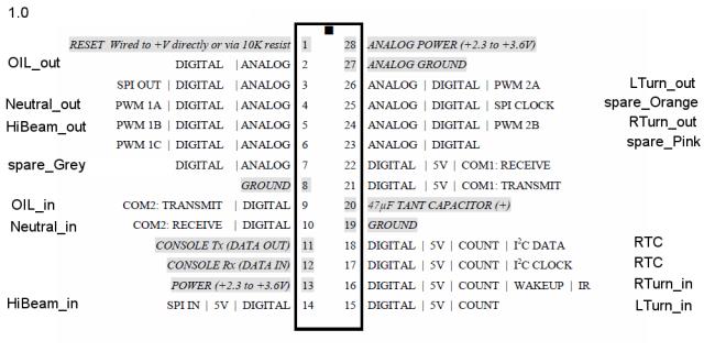

I have a project using a 28 pin '170 that requires to COUNT on a pin that is not specifically able to do it i.e. not pins 15 - 18. It's potted and the only spare pins brought out are 23 & 25 so no opportunity to adjust -

I did look at the ChangePin CSub in the firmware distribution but couldn't see how to make it work to get the count onto another pin.
What you show above looks really useful but sadly I am limited with what is available and the project has a RTC, so pin 18 is in use.
The count pins were used fairly rapidly because of their 5V tolerance (although they have opto-isolators on their inputs also) and now a change is required after the module has been in service for a while - even so it is potted so I have no opportunity to re-jig the pins used.
Here is a map of what I have available, the three spares are the only stuff available.:
With some inconvenience, it would be possible to re-assign a pin, say 15 or 16 but if I can get round this with some clever software so much the better. It may be I am out of options. I thought about using the soft i2c from the embedded library, but the thing is potted so I can't get to them anyway
cheers
