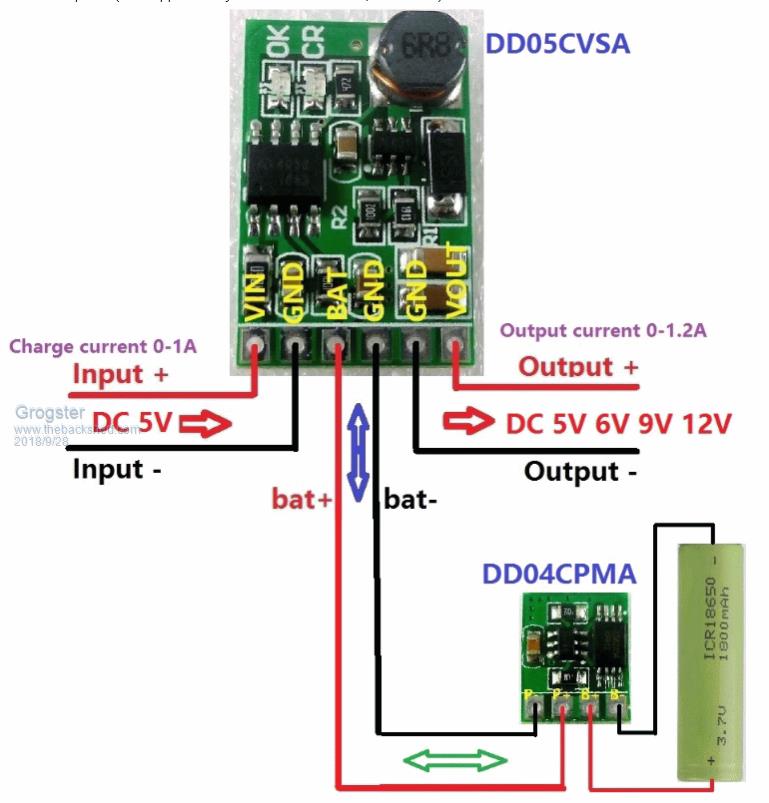

However, I have found this very interesting module which uses ONE 3.7v cell, and combines a charger and a boost converter, so you can use a 3.7v cell to produce 5v, 6v, 9v or 12v with a corresponding drop off in the current you can suck from it. If you add another cheap module , you can add battery protection aswell. I'm quite impressed with the boost-converter idea, as single 3.7v cells are much easier to get, smaller, cheaper.....
EDIT: Wikipedia tells me you can get an 18450 which would be just about perfect. They won't be as common as 18650, but C'est La Vie. Jaycar might even stock something close. More research.....Edited by Grogster 2018-09-29

Well, I have to admit that I have also been thinking THAT too. While I like the LiPO for it's current density vs weight etc, there is a-lot of monitoring needed with those cells. Rough and ready NiMH 9v batteries are pretty good as a power source for 28-pin MM projects, when paired with some LDO regulators, and the CPU SLEEP command.
I may yet just stick with the rechargable 9v batteries and be done with it.

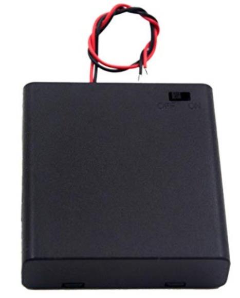

Not to hijack this thread, but it's already forked to a degree--is there a 3-AA or 4-AA NiMH box with plug-in for 5V phone/r-pi charger and charging control? Something like the standard 4-AA box with switch, but with a little more in the way of smarts?
