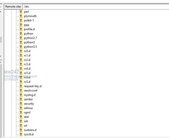

  matherp said
This can then easily be included as part of the boot process by adding the following lines to /etc/rc.local
I don't have an rc.local folder?
Posted: 03:50pm 23 Sep 2018
  Quote  I don't have an rc.local folder
rc.local is a file
edit it:
sudo nano /etc/rc.local

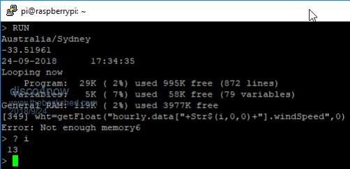

Posted: 07:49am 24 Sep 2018
Hi Peter,
I am getting the error below in 5.21 but not in 5.20.
Both on a PiZero-W and a Pi3. One Jessie one Stretch
It is around the area of repeated JSON calls to extract data from a large data set.
It fails on the 13th loop with 3 JSON calls in the loop. I have printed MEMORY at loop 12 but normal memory seems OK. If I only have one JSON call in the loop I get 40 iterations before it errors.
Works for 5.20 with no issue.
Error: Not enough memory6
The getFloat function just call JSON. ie.

Posted: 01:26pm 24 Sep 2018
The error says it is running out of temporary strings.
I've upped the number in this build. I'm not aware that there was any change recently in this area but please try the attached
2018-09-24_232629_mmbasicjessie.zip
2018-09-24_232642_mmbasicstretch.zip

Posted: 06:00am 25 Sep 2018
  matherp said   The error says it is running out of temporary strings.
I am running the Stretch version and it runs OK ie memory6 error is fixed.
