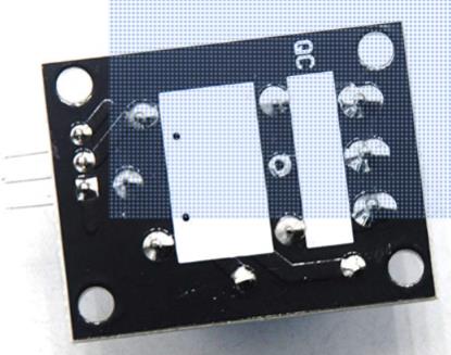

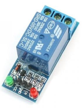

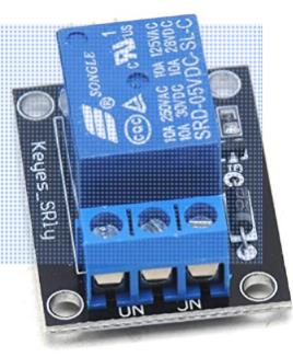

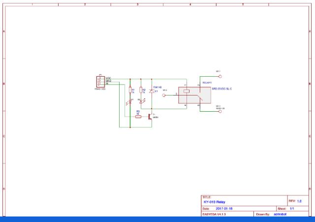

Here is a link to a pdf
KY-019 relay
From the looks of it the Schematic has the transistor E C swapped.
If you have one you could measure Vled and the VBE. You could then adjust
the trip voltage down ward by removing the LED adding more resistance to
keep the current safe for the driving pin.
A bit later found this schematic with same part number at
also KY-019 relay
and in this schematic it looks more like you may able to use a lower voltage.
I couldn't read the transistor number to look it up.
I also noticed that one of do not these have a high voltage slot/gap and with
120/240 AC should be used with caution.
Images of these two KY-019 relays
and
Heres hoping any of this helps.

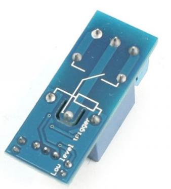

Some of the relay boards are 'active low', which can be annoying.
