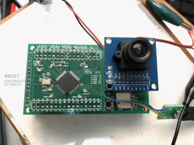

astro1
Joined: 26/06/2016
Posts: 53
Posted: 11:40pm 15 Sep 2018
The camera works ok on the MMX144, wanted to use it on my MMX64.
Signals all come from the camera, after open.
Setup picy.
plover
Joined: 18/04/2013
Posts: 306
Posted: 01:35am 16 Sep 2018
What are the black and green alligator gribs doing? Supplying power? and do I see your keyboard just under or nearby. If it is power supply it may pay to run the +/- cable alongside each other, like the red/black in the middle of the photo.
You could also look with your Scope and see what sort of noise you actually have on the power supply depends on how good your scope is whether it is worth the effort.
