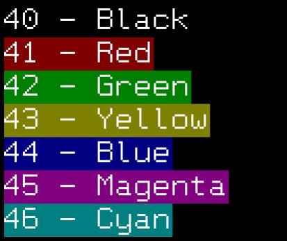

i've not so far provided any way for the user to do so, apart from using ansi escape sequences that would be overriden when starting up the editor or resetting the terminal.
if the background colour were made user settable in the same manner as the foreground colour currently is (by changing the VT default), the selection available would unfortunately be rather boring:

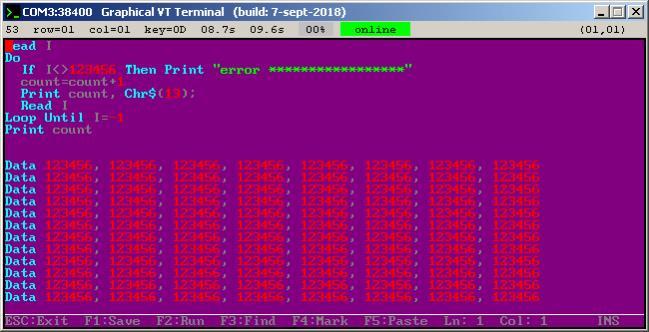

here is a purple example:
would being able to do this be useful to anyone?
