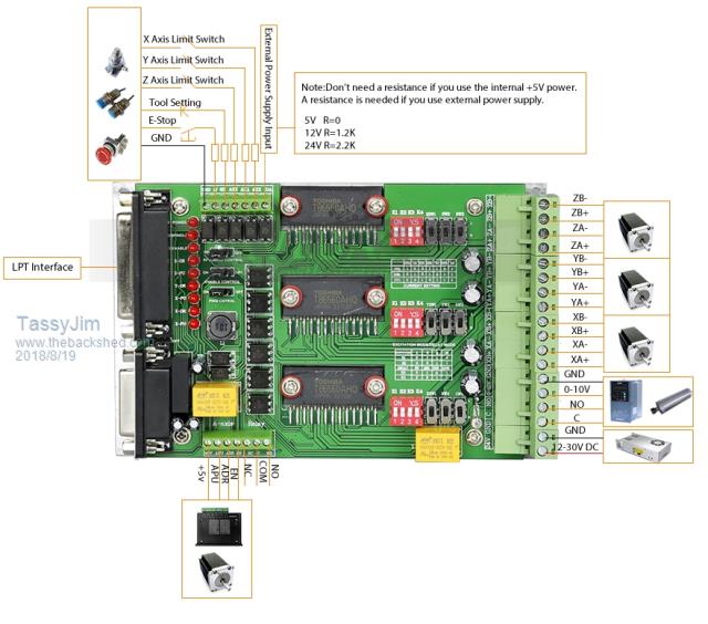

These boards are cheap and readily available. They use the TB6560 chip.
Driving one with the micromite would make a great base for robotics experiments.

The boards that you show use the chipset thats in the Toshiba family I mentioned in my earlier post - I like the board u posted because it has 3 circuits - useful !
(X, Y & Z axes).
