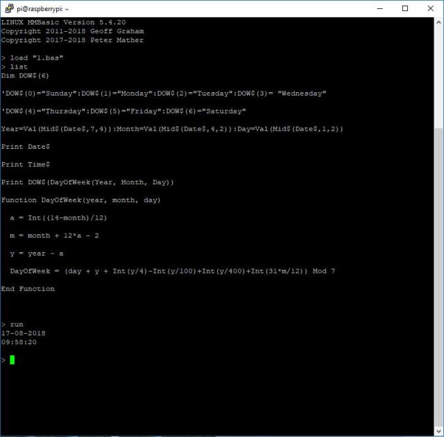

It's still giving the same result

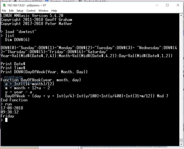

Posted: 09:11am 17 Aug 2018
Your code has CR and LF at the end of lines. Linux expects just CR.
You have commented out the lines setting up DOW$
This is better syntax anyway
DIM DOW$(6)=("Sunday","Monday","Tuesday","Wednesday","Thursday","Friday","Saturday")

Posted: 09:17am 17 Aug 2018
Sorry Peter, I put the comment in when I was trying to find the error and wanted it to print the day numberal
it's working now

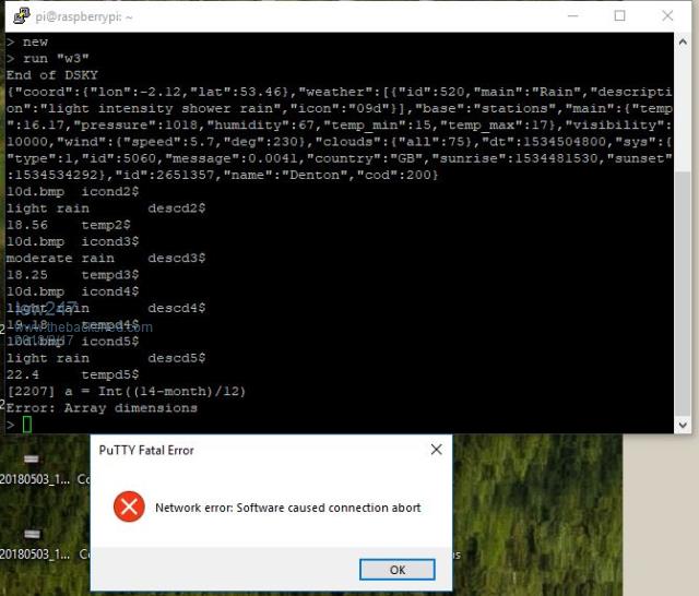

Now it's doing the original problem which is why I tried the DOW function on its own with no program
Now I've integrated it into the program I'm getting this AND the Pi crashes and I have to reboot
The function is the same one I was using that worked

Posted: 01:44pm 17 Aug 2018
There is a known issue with the Pi-cromite that some, but not many, MMBasic errors cause a crash. I have been unable to track this down as is seems as though it is a compiler and/or linker error.
The problem in your code is almost certainly that the function is returning a negative number or a number > 6 which causes the MMBasic error in the first place

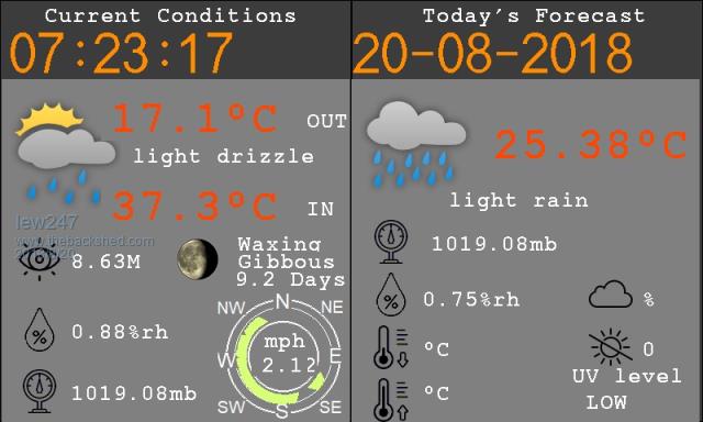

Posted: 06:28am 20 Aug 2018
Blit doesn't seem to be working properly?
The "compass" is a picture and the arrow should only be showing one position
Azure
