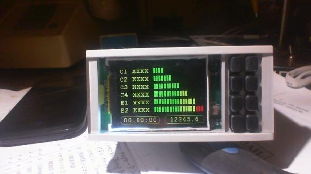

A big thank you Geoff for the addition of the new internal Gauges to the new firmware..! Currently using both types in the DIN panel instrument design for the engine information system I'm trying to get done... Currently using 6 20 segment bar type gauges for CHT ant EGT thermo temps... Will be using the round gauge for RPM... The design uses the 470 MPU...
2018-08-15_201238_DIN_Panel_MPU_Engine.pdf

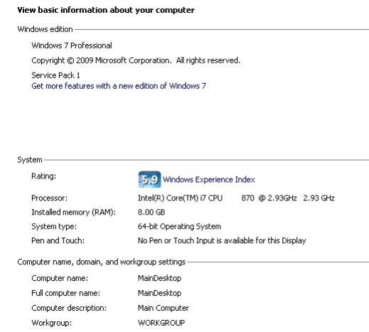

Wow.. Thanks Jim..! I did not know that... Currently using Win 7 here...
I read through the thread you posted, but I am a little confused by it all...
Why does everything work ok until I setup the ILI9341 display..??
I am running the board off of USB power from a powered USB hub..
I can provide external power to see if that works...
I am using the Silicon Chip driver for win 7...
Also, why is it when I go back to v5.04.08 that everything works OK..??
I wasn't planing to "upgrade" this computer to Win-10...
Not sure what the next move should be... I do want to try out v5.04.10 firmware and play with the new GUI bar gauge objects but not sure what my options are to resolve this issue... Thanks in advance for any insight you could provide..!!

Ok... I will wait for Geoff's response before going any further..
@Azure
  Quote  Just out of curiosity what MM Hardware setup are you using?
I designed a set of boards that fit into a DIN panel box I can get from Turkey..
I wanted to code up an EIS to use for Ultralight aircraft use... It has 3 boards in the design, the MPU engine board, power plus board and the temp input board..
the 2.2" LCD display fits just right and after doing several other design projects, I am trying to get back to work on this one.. I like the box, as it is still small enough to not take up to much room in the cockpit panel of the airplane and has a simple set of buttons to change display screens without using "touch" on the display...
If others are interested, I can layout different PCB's for the 2 other boards and just provide a "sea of holes" to allow prototyping of what ever you want on them...
Externally, the box lets you have 2 12 pin connectors to interface to the "outside world"...
Here is the info on the 2 boards I made that plug into the MPU engine board...
2018-08-19_143731_DIN_Panel_PWR-PLUS_Plug-in.pdf
2018-08-19_143819_DIN_Panel_LTC2983_Temp_Plug-in.pdf
I hope this answers your question..!
