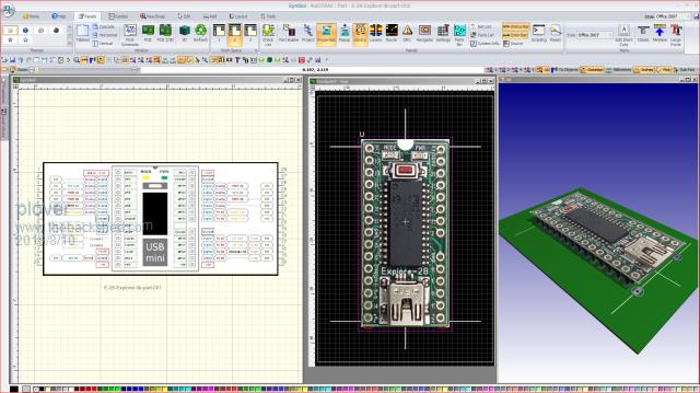

I am building a library part in DEX for the E28-Explore, due to my poor memory I am adding a fair bit of information into the schematic symbol. The info is from a picture here in TBS but the quality is a bit unclear.
https://www.thebackshed.com/forum/forum_posts.asp?TID=10462&PN=1&TPN=1
Does anybody know where the original picture comes from? I would like a sharper picture for my part

Found this. May help.
Try Here Edited by Chopperp 2018-08-11

Posted: 12:07pm 10 Aug 2018
Chopperp
Thank you very much. You are spot on. Though I almost missed out, I thought the post was the same as I had already found but of course it was one of the posts I did not find.
A second glans scrolling down and I spotted the pdf attachment, the print out from pdf file is much clearer which will be helpful when scaling it down.
