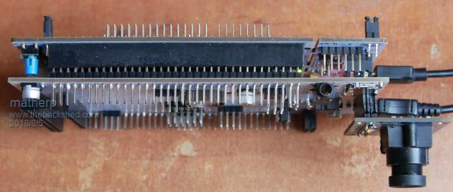

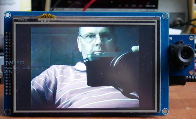

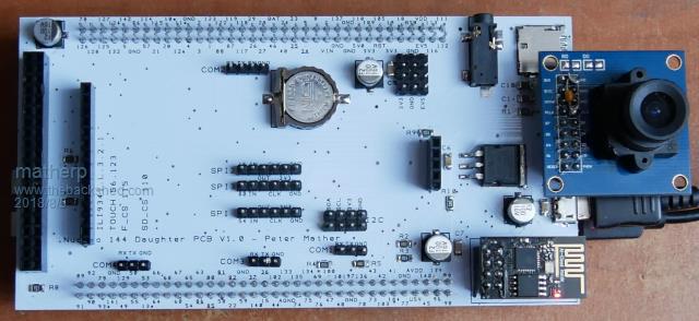

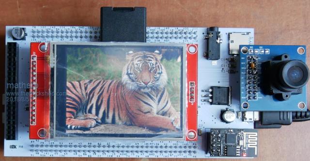

Patch wiring lots of cable to displays, camera etc. is painful and open to error so I have developed a backpack to allow connection to the Nucleo 144 of various peripherals.
It supports ILI9341, SSD1963, OV7670 camera, ESP8266 module (Com3), battery for RTC, audio output socket, as well as dedicated ports for Com1, Com2, Com3, Com4, SPI1, SPI2, SPI3, and I2C. I've used tall headers so all the Nucleo pins are also available.
This first version included an SDcard slot for the 4-bit parallel interface which I have now scrapped but the SDcard slot on the displays can be used. The attached gerbers have the SDcard slot connected using SPI.

Minor tweak to include LED-A support for ILI9341 16-bit parallel displays like this .
2018-08-06_184257_stm32h7.zip
Parts list for those interested.
C2, C3, C4, C5 - UWX1C101MCL1GB or similar
C1, C6, C7, C8 - 0.1uF 1206
C10 - 10uF 1206
R1, R10 - 2R2 1206
all other resistors - 10K 1206
Regulator - LD1085D2M33R
Battery - CR1220
Battery Holder - S8411-45R
Audio socket - 35RASMT4BHNTRX
SDcard socket - 114-00841-68
USB socket - ZX62D-B-5PA8(30)
NB the power selector (JP3) on the Nucleo should be selected to E5V to use the daughter boardEdited by matherp 2018-08-07

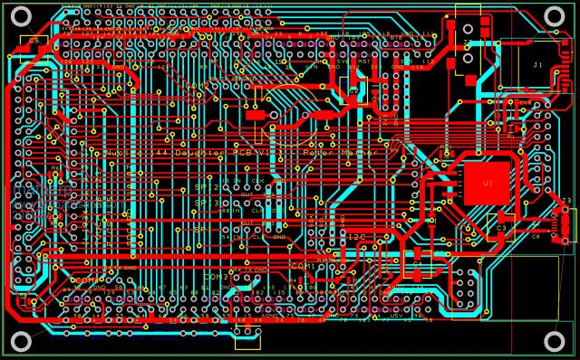

I decided it would be good idea to increase the size of the backpack to allow the 5" SSD1963 display to be mounted properly. As this gave me more real estate I've also included a Raspberry Pi style header which will allow Pi HATs such as ILI9481 style displays to be plugged in. I've also added an optional IR receiver and optional pullups on 8 I/O lines for things like DS18B20. This is then Version 1.3. As always comments appreciated. Ground planes are removed for ease of inspection.
I've checked COM4 RX and TX on the Nucleo Arduino header and they are definitely the correct way round in the latest release of the firmware - someone suggested there may be an issue.
