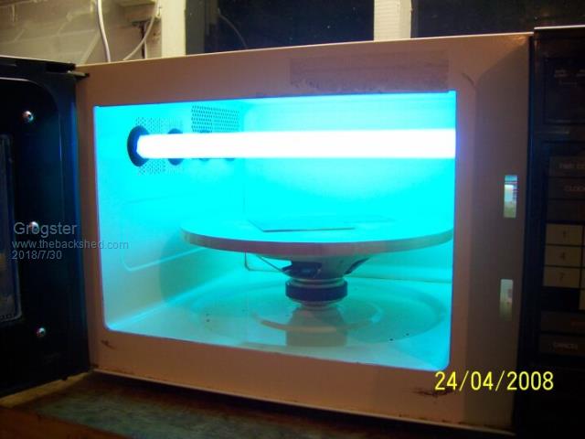

This was my home-made one I used for years, built out of an old microwave oven:
I still use it to UV test things to find out if they break down. A few hours on high.....
PCB's are just so cheap out of PCB houses in China now, that making your own at home is just not worth the effort anymore in my humble opinion.

  Quote  This was my home-made one I used for years, built out of an old microwave oven:
Now that's something to like!
Is that a speaker cone instead of a turntable?
Posts: 10114
Posted: 05:57am 31 Jul 2018
Yes, I used an old 8" speaker as a chassis thing for elevating the new wooden turntable up closer to the UV tubes. It is connected to the turntable motor, and turns the boards in the UV light just as it used to do when cooking food. This project was published in Silicon Chip magazine about ten years ago or so. It even featured on the cover, which was a nice surprise for me when I got that issue!

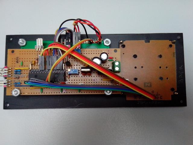

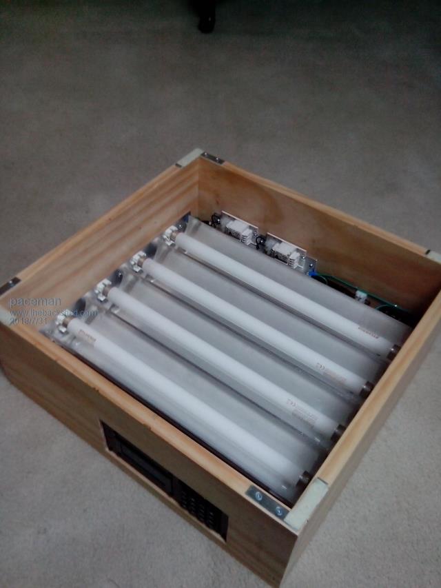

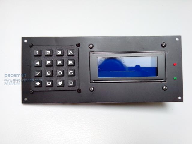

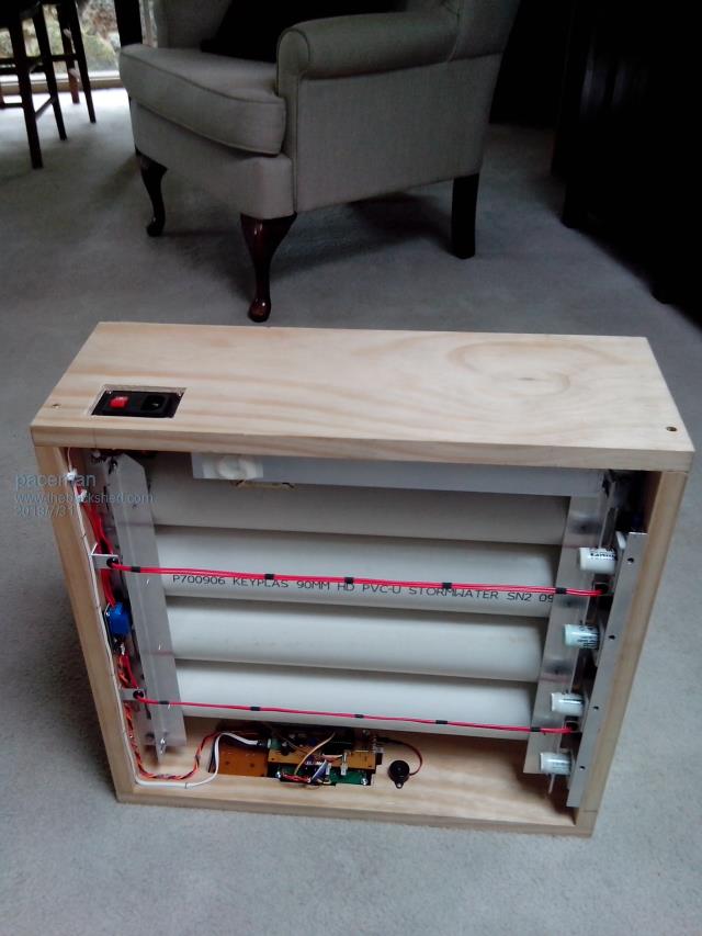

Anyway, Andrew_G came around today and he now has the unit I built back in mid 2014 using 90mm split pipe lined with aluminium adhesive tape for reflectors, UV tubes and a MMX150 uMite controller (MMBasic V4.5) with a 4x4 keypad and 4x20 LCD display. Some pictures for everyone below just for fun. I was going to write this up properly for TBS but the cheap and good stuff that came out of China about the same time made it seem a bit pointless.
