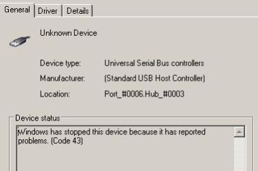

Here's a few more screen shots -
The Devices and Printers showing the normal (Ver 5.04.08) driver
The failed port notification after entering the screen OPTION LCDPANEL command in V5.04.10
Device properties on the USB port after OPTION LCDPANEL command
It's really strange to me that when I go through the steps to install 5.04.10, the MM+ works (it runs code) but the windows driver faults out after configuring the screen, yet, when I go through the same steps to install 5.04.08 it happily accepts the same screen command with the same screen configuration that I've had since first install.

  Quote  Do you get the message "Restart the Micromite+" after you set the display option and before you restart or does the driver immediately fail?
Got the message to restart, so I disconnected the USB to reset the MM.
When it gets powered up again, there's a long windows delay (10 seconds?) before I get the Device Not Recognised Fault
  Quote  After you get the Windows driver error, have you gone through the disconnect, power down, re-power, reconnect process?
Yep, many times
I even uninstalled/scan for changes/reinstall the SC drivers.
