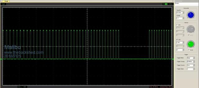

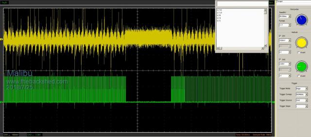

It took a few tries to get a capture, but this is perfect to explain what my question is...
Top trace is the voltage/signal across the current sense resistor on the DRV8825.
Bottom trace is the step input pulse from the MM.
The MM Chat window is open so I can see what stage the loop is in.
So, step mode has just gone from 1/4 to 1/2 on this capture, but right at the end of the 1/4 mode, the step pulses from the MM drop out completely (hard to see how many pulse are missing, but there's a lot). You can see by the 'patterns' on the top trace to the motor what the result is when the steps drop out.
This is a random occurance, and only seems to happen during the ramp-up part of it, and at any step mode condition, but not while there is a set speed. The stepper has been happily running for 20 minutes now on a set speed (in full step mode)
Sorry for the poor picture - it's a screen capture of a screen recording that was around 3 minutes long, and this was the clearest example on it.
So, any ideas on what I'm doing wrong this time?
Edit - Sorry, I should have said this is running Min=600 & Max=1200Edited by Malibu 2018-07-26

I haven't traced the output, only the PWM signal this time.
As you say, it's around 100mS (closer to around 90mS by the looks of it), but it's still there.
As an observation, it only seems to happen:
A) On ramp up timing
B) On the lower frequencies
C) Again, with no regular position or amount of times.
On saying it's 100ms second timing, it may be happening on a shorter Hz count, but my crappy DSO setup is just missing some of the skips and they might be happening too quick to have a noticeable effect on the RPM's.
Is it possible that the "PAUSE" statements are causing the PWM to hang?
I'm at a loss on this one, so I appreciate your help...

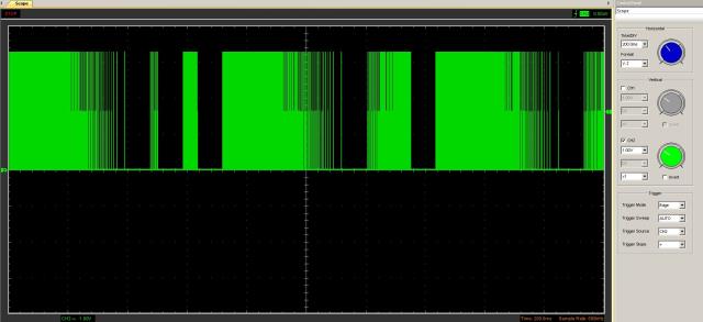

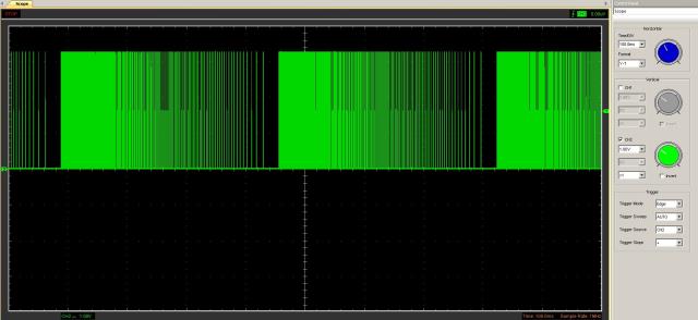

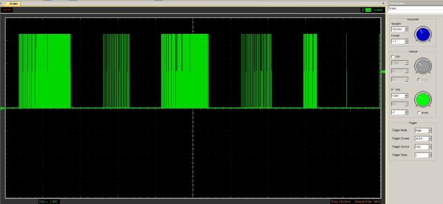

So, with the RAMP UP code commented out (ie: only ramping down), here's the results.
A nice and clean, sweeping waveform that makes sense...
Comment out the RAMP DOWN code, and only run the RAMP UP and here's what happens.
Looks like it's only on a frequency increase...
So, here's the full code running...
None of these DSO grabs have the DRV8825 board in place (and by default, the motor isn't running)
When I first got this glitch I was pretty sure it was a hardware and/or wiring fault, or maybe I'm losing my marbles - but I'm starting to think it's neither...
I'll keep playing and see what else I can come up with... I seriously need a COFFEE right now!!

Hi Panky,
  Quote  the PWM controller is being reset each time through the loop
Ok, so what you're saying is that the PWM has got a new command before it's finished with the old one?
An idea that I hadn't thought of, so I'll ponder that one. It could explain why it only happens on an increase in Hz and not a decrease.
  Quote  executing PWM 1,2000,50 from the command line and monitoring the PWM output at the constant frequency of 2000 shows no jitter
Nope, no problems with fixed frequencies here either. There seems to be quite a lot of noise for me too, but I just put that down to the Hantek USB CRO
Azure,
  Quote  Using MM+64 LCD Backpack running 5.04.09. Running from USB power and nothing else connected to MM
Same as what I have at the moment, but 5.04.08 (I even took out the LCD to be sure)
  Quote  varying as a percentage (25%) of the frequency. So at the low ramp speed (i=50) the pulse will be fairly long and at high speed the pulse will be much shorter (i=2000)
Yeah, early on I was playing around with the % duty and even tried 1% at 20kHz. It was such a short signal, I think the capacitance in the circuit started to play havoc. The specs on the 8825 chip says a minimum pulse width of 1.9uS, so 25% duty should have it covered.
  Quote  It ramps up and down with no break in the PWM pulse at any time.
No worries, thanks for that confirmation... I'll need to check a little more and see what else I can come up with.
I'm sure Geoff is going to find the same thing as you, so thanks to all for your valued input...

Looks like a race condition. To increase the frequency of the PWM you reduce the value of the Period register (PR). If the new value of the PR is less than the current count the PWM counter will continue to its maximum count causing a glitch.
Imagine the PWM clock is 1MHz, duty cycle = 50% and the frequency is 100Hz. That means the PR would be set to 9,999. On each cycle the PWM counter counts up until it hits 9,999 then resets. The output is set to 1 on reset and to zero when the count hits 4,999. If the frequency is changed to 101 Hz then PR must be set to 9,900. If the PWM counter is currently at 9,950 then it has already missed the reset point and will continue until the counter overflows and returns to zero by itself resulting in a glitch. The lower the frequency the more likely you'll get a glitch.
If you are decreasing the frequency the Period Register is increased so it is impossible for the PWM counter to be higher than the Period Register.
The glitch is hard to detect, you need to set your scope to trigger in pulse mode then select a 0 pulse greater than 1ms.
The PWM hardware allows duty cycle to be changed without problems as the new duty cycle value is buffered then loaded when the counter resets. However there is no buffer for the Period register. To avoid a glitch you'd need to change the code to wait until the PWM counter resets.

  Quote   If the PWM counter is currently at 9,950 then it has already missed the reset point and will continue until the counter overflows and returns to zero by itself resulting in a glitch.
Jimbo, thanks for that explanation... that makes sense now as to WHY it's happening.
I dredged up a few dusty memories of register operations in 16f84's and mentally put them into this context, and I can see the problem now! Thanks
I think half my problem is the DSO - it's ok, but woefully lacking in some areas (I need a REAL one)
I know I can get a smooth ramp with steppers, it's just finding the best way and I'll hit it hard for a while using the PULSE command (Fingers Crossed!)
