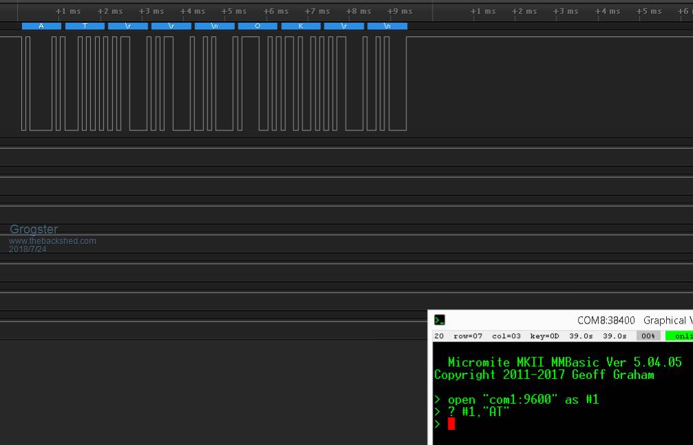

This odd twelve-second low is also making it totally incompatible with the MM com port. I have wired it to an E28 for the purposes of testing, and the MM com port totally ignores the module. If I continue to connect this module via a 3232 level corrector to COM1 on the PC, it talks, but that is useless, as I need it to interface to the MM COM port. Not THAT impressed with this module, unfortunately.
The next thing I am going to do, is put the Salie Logic on the MM com port while connected to the module, and send it a text and capture the output.
EDIT: This is getting interesting. With the logic analyser directly on the output of the module, it captures any text message I send to it. As soon as I put TXD onto the MM RXD, the line stays at 3v3 and never shifts. So, with it connected to the MM, and you send it a text message, NO DATA is received at all. Voltage across the module TXD and GND when idle, is 3.26v, which sounds right. Voltage across the module TXD and GND when connected to the MM RXD is also 3.26v, so the MM cannot be pulling the line down or anything, but if connected, no data, if NOT connected, data. Very odd..... I will now check the same idea with the logic analyser across the module and the CP2102 USB-serial adaptor that refused to work yesterday - I bet it is the same. My guess is that it is working on the MAX2323 module, as it is buffered, whereas the MM and the 2102 are not - it's right down the throat of the UART.Edited by Grogster 2018-07-25

Posts: 10114
Posted: 03:54am 24 Jul 2018
Progress - perhaps? I get a result with that configuration.
I can SEND it a message from the MM, and I can read back the "OK" it said in response, to the logic analyser, but not on the MM or any USB-serial adaptor. Something odd going on with the TXD from the module. I'm kinda lost now.

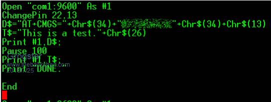

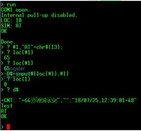

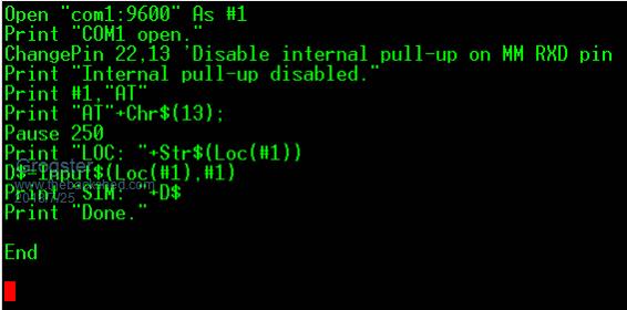

A bit more reading (RTFM) to dig further into the matter: MM Manual Pages 85 & 86
  Quote  When a serial port is opened MMBasic will enable an internal pullup resistor (to Vdd) on the Rx (receive data) pin. This has a value of about 100K and its purpose is to prevent the input from floating if it is left unconnected. Normally this is fine but it can cause a problem if you have an external resistor in series with the Rx pin, in that case this resistor and the pullup resistor will form a voltage divider limiting how high or low the voltage on the Rx pin can swing and that in turn might mean that the input signal is not recognised. The solution is to use the embedded C routine ChangePin to turn off the pullup after the serial port has been opened. ChangePin is included in the Micromite distribution file (the zip file) in the Embedded C Modules folder. Note that a pullup resistor is also applied to the console's Rx pin and it too can be disabled using ChangePin.
The module being used does have series resistors on both Txd and Rxd.
So there are 2 options:
Software - give the ChangePin routine a try;
Hardware - short out the series resistor (should only need to do the modules Txd pin).
If you do short it out, try and do it nicely so you can put it back the way it was if needed after things are sorted out.
Just out of curiosity, what is the value of the series resistor?

The Sleep input is used to wake up the unit if it goes to sleep (apparently pulling TDR low will wake the chip up from sleep).
The PwrKey will put the unit to sleep.
These pins on the module can be left unconnected unless you want to use these functions.
You could measure R118 and R119 with a meter while they are not connected to anything (if the value is not printed or to small to read on them). Just peace of mind stuff to see what the voltage divider would be with the MM internal pullup.
Posts: 10114
Posted: 05:50am 24 Jul 2018
Yes, I will find a way to measure them - they are tiny, but under the scope I think I could measure them with needles for meter probes.
EDIT: Both those series resistors are 1k.Edited by Grogster 2018-07-25
Azure
Joined: 09/11/2017
Posts: 446
Posted: 06:14am 24 Jul 2018
Well based on those values and the MM internal pullup values everything should be ok. I was hoping they would be something much higher.
...One step backwards.
I would not bother shorting the resistor and try the ChangePin function first.
