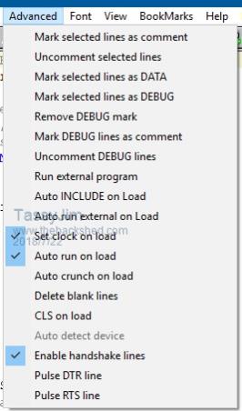

I've been trying the various editor options and have a really newbie MM Edit question. Should "load and run" normally do just that? So far I find it loads but doesn't run.
Posted: 03:04am 22 Jul 2018
What options do you have set.
Here I have "set clock" and "Auto run" as the only two options when using "Load and Run"
You can also set the options in "Preferences"
Also, make sure you have the correct syntax file selected.

Ah, thank you, that will be the problem. I had missed that the "run" part was an option.
