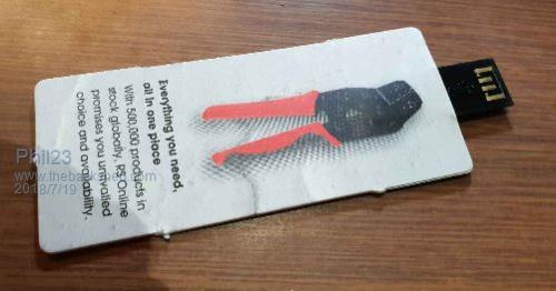

Hi All,
Wondering if anyone knows anything about this?
It was in some promo material from RS Components a few months back.
I presumed it was a flash drive.
But just plugged it in before binning it & it turns out to be a "USB Input Device" that it creates in Device Manager.
It then sends out keystrokes to open the Run Box & enters "http://secure-ctw.com/pm", which then send you to RS's website.
Different....
Wonder if it can be re-programed....
Phil.

A lot of Promo USB drives have some info pre loaded on them that cannot be erased or reprogrammed. Formatting the drive does not usually effect the preprogrammed part of the drive.

Careful with those.
Some of them are ID theft things. With RS Components, you are probably pretty safe, but ANY flash drive that tries to execute code to log keystokes and send them off somewhere, could be misused for the purposes of stealing all sorts of information.

Pretty much the standard with promo usb sticks, Company I used to work with ordered a few hundred (300 from memory) they programmed our website link onto them from the factory and that couldnt be changed- which was a pain when they changed the company name lol

I echo Grog's caution here - never plug in a device that you don't know its "heritage" entirely. A favourite trick around the banking district of London a couple of years ago was very similar idea on devices that plant crap on machines, with a view to getting somewhere important, nice and quiet so as not to arouse any suspicions. Major companies have recently (last 5 years or so) completely locked down any USB ports as the devices can look like a HID (keyboard, mouse etc - just as this one does) and the'rs no stopping it. I could build a device in about an hour to act like a keyboard and open up some site in a browser . If I can do it so can any script kiddie. Anything you can do from a keyboard... i.e. Windows R, HTTP://hackmypc.com, return... and it's almost certainly too late.
They can be manufactured for pennies and then conveniently "dropped" in areas where people will pick them up, pavements, bars, toilets, tube trains, buses, taxies... in huge numbers - they only have to be lucky once. People take them and either think "ooh! free USB drive" or "Hah! someone has dropped this lets have a poke around and see what we find" Only to get pwned.

Or, as in the case of StuxNet, can cause some significant havoc.
The initial seed was from a USB stick on a Windows system, but its target was the Seimens PLC systems in Iran's nuclear program.
