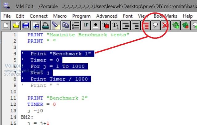

Please realize that the block comment also has impact on but RUN mode and EDIT mode in the Maximite and Micromite, but also in MMEdit.
MMedit already has a function to comment out blocks. The hard way. Adding a single quote before every line in the selected block. Maybe you should use MMedit...?
