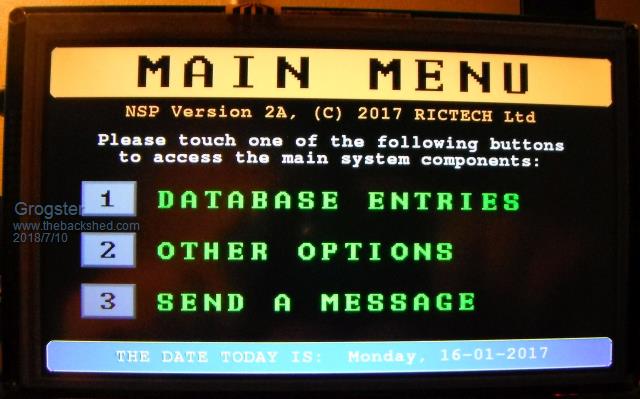

I setup a one-dimensional array to hold the days:
DOW$(0)="Sunday":DOW$(1)="Monday":DOW$(2)="Tuesday":DOW$(3)="Wednesday"
DOW$(4)="Thursday":DOW$(5)="Friday":DOW$(6)="Saturday"
...then a Function to calculate the day reference:
function DayOfWeek(year, month, day)
a = int((14-month)/12)
m = month + 12*a - 2
y = year - a
DayOfWeek = (day + y + int(y/4)-int(y/100)+int(y/400)+int(31*m/12)) mod 7
end function
...then used a simple SUB to build the date string whenever I needed it:
SUB BUILD_DATE
YEAR=val(MID$(DATE$,7,4)):MONTH=VAL(MID$(DATE$,4,2)):DAY=val(MID$(DATE$,1,2))
DOW_DAY$=DOW$(DayOfWeek(YEAR,MONTH,DAY)) + ", " + DATE$
CtrlVal(MM_DAD)="THE DATE TODAY IS: "+DOW_DAY$
END SUB
Result:

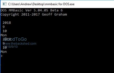

I'm still having problems with the day of the week function
It keeps saying the day is Sat
Can anyone see any problems with this code?
I'm using a PICROMITE - the code should be identical to any other version of the MM though
[code]
DOW$(0)="Sun":DOW$(1)="Mon":DOW$(2)="Tue":DOW$(3)="Wed":DOW$(4)="Thu":DOW$(5)="Fri":DOW$(6)="Sat"
Year=Val(Mid$(Date$,7,4)):Month=Val(Mid$(Date$,4,2)):Day=Val(Mid$(Date$,1,2))
dowx1$=DOW$(DayOfWeek(YEAR,MONTH,DAY))
do
print DOW$(DayOfWeek(YEAR,MONTH,DAY))
pause 2000
print DOW$(DayOfWeek(YEAR,MONTH,DAY)) @print 2nd time to see if it changes the day after a pause
end
print year 'to check if it's correct
print month 'to check if it's correct
print day 'to check if it's correct
local a,m,y
y = year - a
end function
[/code]

  lew247 said   I'm still having problems with the day of the week function
Hi Lew ... It looks like your code repetitively extracts Year, Month, and Day from the MMVar DATE$. If you run this under DOS then DATE$ will get the current date from DOS (Windowze?). If you run it on a chip it might return the correct date if you have an RTC module hooked up and it's set properly, or if it has access to a GPS receiver. If you just start up a cold PIC chip I don't know what DATE$ will initially return. It does make sense that it will repetitively return the same day, ("Sat"), if DATE$ doesn't change. I have added comments and indented your code below.
Paul in NY
[code] DOW$(0)="Sun":DOW$(1)="Mon":DOW$(2)="Tue":DOW$(3)="Wed":DOW$(4)="Thu":DOW$(5)="Fri":DOW$(6)="Sat"

Joined: 23/04/2017
Posts: 188
Posted: 06:25am 10 Sep 2018
Hi Lew,
I tried your code in DOS MMBasic ver 5.04.05 Beta 6 and it worked fine after I made a couple of edits:-
I had to declare the variable DOW$(6) at the start,
I commented out the 'do'
I commented out the 'dowx1$=DOW$...etc etc line.
dim DOW$(6) as string
'dowx1$=DOW$(DayOfWeek(YEAR,MONTH,DAY)) 'DOESN'T DO ANYTHING BECAUSE dowx1$ IS NEVER USED BELOW
'do 'THIS DO DOESN'T DO ANYTHING BECAUSE THERE IS NO LOOP BELOW
pause 2000 'YEAR, MONTH, or DAY don't change during this pause
'DATE$ will change if you pass midnight during the pause
'but YEAR, MONTH and DAY still won't change unless you specifically
'set them again with line #2 above
print DOW$(DayOfWeek(YEAR,MONTH,DAY)) '@print 2nd time to see if it changes the day after a pause
end
local a,m,y
y = year - a
end function
And the result was:-
Is the format of Date$ the same in Picromite as it is in the normal MMbasic?
ie. dd-mm-yyyy format?
Cheers,
GTG!

lew247
Joined: 23/12/2015
Posts: 1709
Posted: 07:17am 10 Sep 2018
Thanks G2G
I thought I'd got everything correct
In my code I had
DIM DOW$ and not DIM DOW$(6)
Tiny little error but stopped it working
Thanks for spotting that
Yes the Date format is the same dd-mm-yyyy
