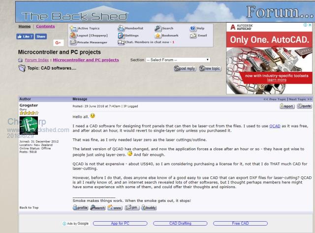

Hello all.
I need a CAD software for designing front panels that can then be laser-cut from the files. I used to use QCAD as it was free, and after about an hour, it would revert to single-layer only unless you purchased it.
That was fine, as I only needed layer zero as the laser cuttings/outline.
The latest version of QCAD has changed, and now the application forces a close after an hour or so - they have got wise to people just using layer-zero. And fair enough.
QCAD is not that expensive - about US$40, so I am considering purchasing a license for it, not that I do THAT much CAD for laser-cutting.
However, before I do that, does anyone else know of a good easy to use CAD that can export DXF files for laser-cutting? QCAD is all I really know of, and an internet search revealed lots of other softwares, but I thought perhaps members here might have some experience with some of them, and could offer their thoughts and opinions.

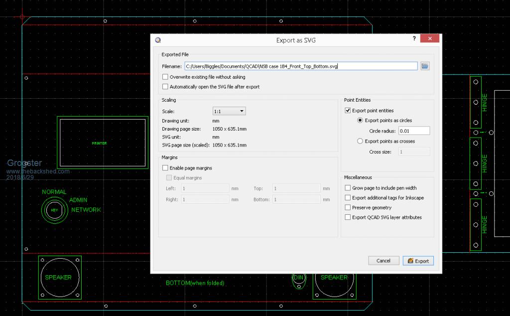

QCAD can export to Inkscape SVG files, so that might be me then.

@ MB: Here is the 'Advanced SVG export' option....
Quazee137
Joined: 07/08/2016
Posts: 603
Posted: 08:19am 29 Jun 2018
Inkscape has been a great tool for may years.
Here's one I am using as a 3D viewer tool.
FreeCAD
there is Linux, Mac and Windows downloads.
Posted: 08:31am 29 Jun 2018
Looks ok. I would deselect 'Export point entities'. Points do not have any diameter or width anyway.
Lines also should be without a line width.
A laser cutter has a kerf of about 0.2mm. If you need very tight fits then you will have to do some tests. For example a 8mm hole will end up being 8.2mm. Most of the time not a problem, but if it is you need to adjust for it by shrinking the diameter with 0.2mm.
This changes with every lasercutter and even with the same machine it changes when using different speeds and power settings.
Extruded acrylic is a more consistent and cuts easier and leaves a nice edge.
Colored acrylics however are often cast and this has more variances in thickness.
For instance a 3mm thick sheet can be anywhere between 2.5 and 3mm. Sometimes you have to keep this in mind when it needs to be tight fitting in thickness.
