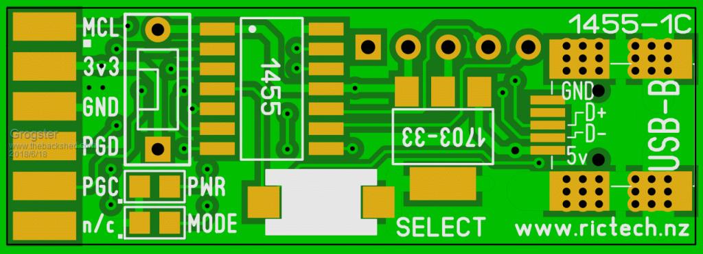

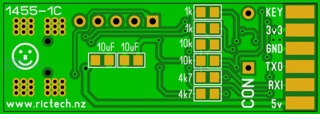

As a follow-on from the thread about the 1A, here is the latest version:
Still a work in progress, but SOIC 1455, DIL switch for 3v3 on/off, 0805 passives, SOT-223 regulator and USB-B socket. ICSP standard pinout on one side of the unit, and console connection on the other. Still fine-tuning the layout, but this is the new design.

I understand the chip is only programmed at 3v3, but if you are running the board using the comms side would you not want the option to power the target board (probably with its own onboard 5v to 3v3 regulator). If it is fed through the 5v from the USB there should be enough to even power an onboard LCD on the target.

In that event, switch OFF the 3v3 DIL switch, and use the 5v supply on the console side of the PCB. Done.

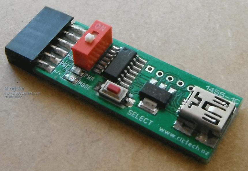

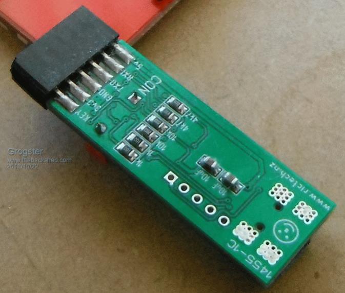

I have finally managed to build this. It works, and Windoze sees it fine as per all 1455 chips.

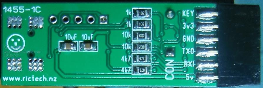

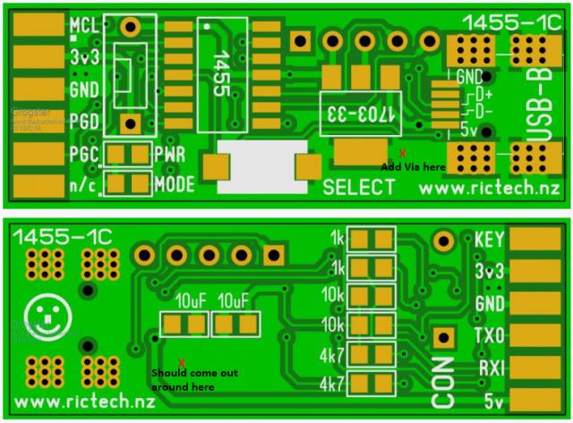

hmmm, there may be a slight problem. the ground connection for the two 10uF filter capacitors (that should be 4.7uf to keep within the USB specs, btw) seems to be entirely through a sliver of ground fill. you may wish to add an offcut of resistor lead from the junction of the two capacitors to the cluster of vias just above the word "rictech".
rob :-)

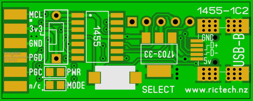

Posts: 10114
Posted: 03:00am 22 Jul 2018

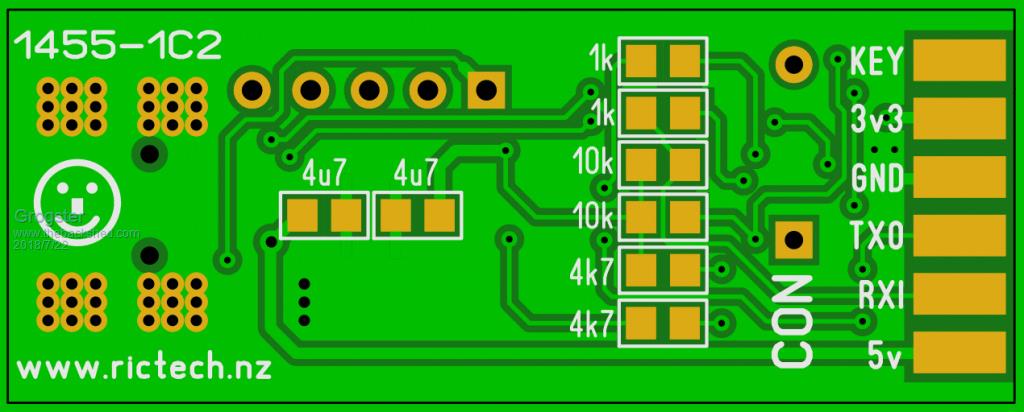

Well spotted! I will alter that to give more copper ground plane for the caps, and change the silkscreen to 4u7.
Posted: 04:43am 22 Jul 2018

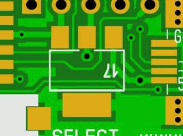

you may be able to just add a ground via:
the other side should come out close to the junction of the caps.
rob :-)

Posted: 06:03am 22 Jul 2018
Or another possible solution requiring less adjustment to the board layout - add a via to the right of the 1703 regulator tab as shown below. This should connect to the ground copper below the capacitor closest to the USB connector, approximate position as also shown below.
Phil.
Posts: 10114
Posted: 06:46am 22 Jul 2018
All of these suggestions have been taken on board(pun!), and this is what we now have:

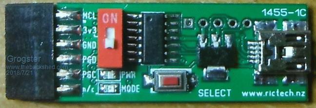

Sorry but I have missed this somewhere. What does the switch do?

The switch allows you to disconnect the 3v3 supply from the 3v3 pins on the connector, primarily to make it easy to use the ICSP side of the connector to program a chip that is mounted on a pcb that has its own power supply and may have other components connected that would overload the regulator on the Programmer/Debugger board.
