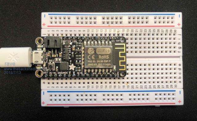

@plover thanks for chiming in!
  plover said
I have had this model(s) in my brain for some time, and others too, I agree many or not really "breadboard" friendly, they are not "Legoish" enough.
Agreed. The ones that are breadboard-friendly typically are 512K, for example the Feather ESP8266 from Adafruit, which has 9 GPIO pins, power and serial via USB, 100mA LiPoly charger and still relatively cheap at $17:
Given the trouble with this thing I'm thinking about upgrading to a newer ESP32 with 4MB flash, e.g. https://www.adafruit.com/product/3405 which is a $20 breadboard-friendly feather board or https://www.adafruit.com/product/3269 which is a $15 development board but looks too chunky for breadboard use IMO.

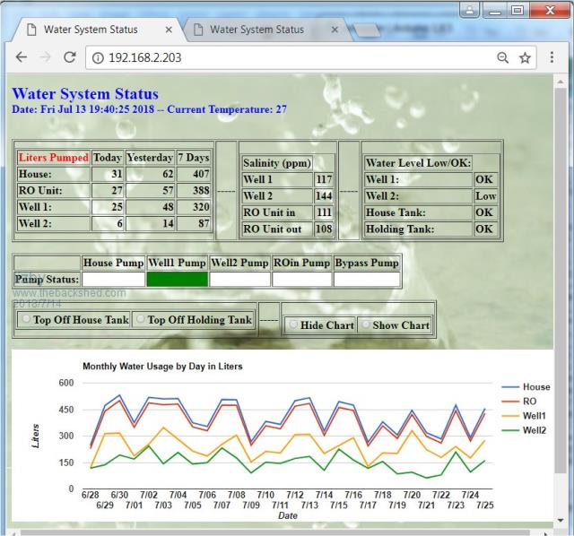

I just ported a picaxe web server to the ESP32 (in C, which I once programmed a lot in, but not in 30 years). Got the module on Tuesday, and got this far today (Friday). I subscribed to Rui Santos' ESP32 tutorial, and it got me to where I needed to be. The html template code is stored in a 24LC64 eeprom, with tokens (~##, e.g., ~01, ~20) where variable values are to be placed. This isn't yet connected to any sensors.
The project was for controlling a water delivery system with 2 saline wells, a saline holding tank, a reverse osmosis filter, a drinkable holding tank, and various sensors and pumps.
The time is retrieved using sntp whenever a connection is made to the (internet-connected) router.
The ESP32 seems to me a quite capable chip. Whether it has the capacity to have MMBasic installed, I don't know. Having wifi and bluetooth is a plus.

me likey!
