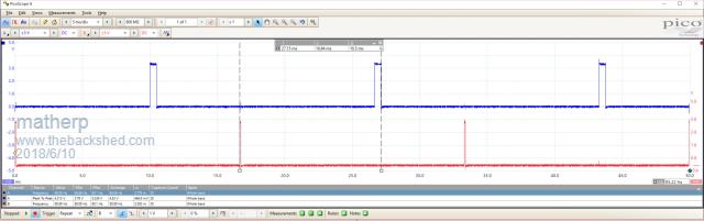

This function takes a trigger pulse on pin-15 (28-pin) or pin-42 (44-pin) MM2 and uses it to create an output pulse on a user-specified pin with a user-specified delay and of user-specified duration.
NB: The Cfunction can not be used at at the same time as IR input
In the example a pulse is created 10mSec after the trigger for 500uSsec
Once set up the pulse generation will operate in the background and create a pulse whenever is sees the trigger. The parameters for the generated pulse can be changed at any time by calling the function again.

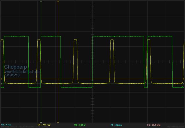

Took me a while to work it out, but I eventually got something going. About the first thing I found out was to use integers for the delay & width variables.
I have it going in a 1 sec loop monitoring a voltage for the width & triggering at 100Hz. (Rectified mains). However, every so often, it will miss a beat as shown by the snapshot below or the width varies slightly. (Delay 1000mS & width ~ 6700mS). It would need to run in a faster loop.
Did some more testing & my trigger signal probably needs improving. I reduced the level slightly from what photo shows & it is behaving much better. More testing needed on my part.
It does appear to have an occasional hiccup when running from the test signal. My test setup is a bit rough though.
This is certainly a huge step in the right direction. Very, very much appreciated.

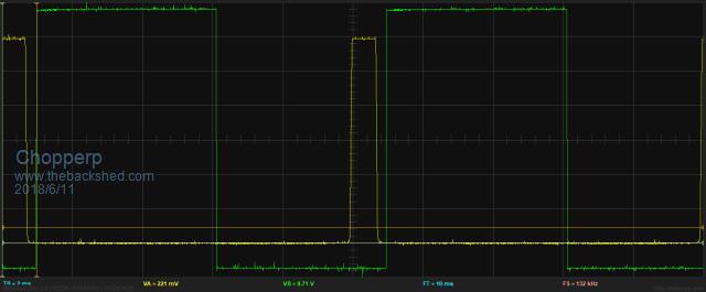

As you mentioned, there is no error correction. I found a too wide a pulse gave an inverted output. Limiting the width solved that problem.

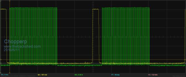

I also experimented with some gating pulses. The idea worked on the breadboard. Yet to be tested in real life though which may take a week or two. QLD Courts reckons I need to do Jury Duty. I'd better go.
EDIT OOPS Just realised that my gated pulses aren't correct. Should be after the pulse end. Back to the drawing board.

Trigger + Normal O/P
Trigger + Gated O/P

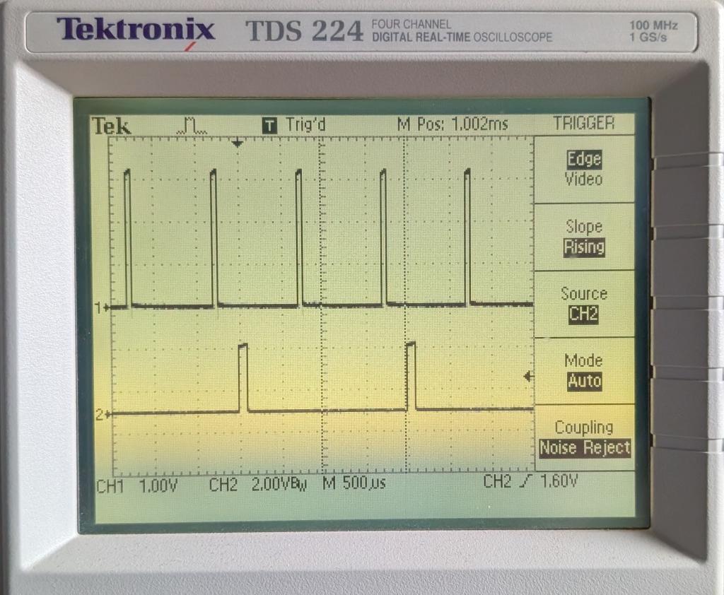

Here is the result of my PicoMite version with the added quiescent period GP6 and GP9 connected.
setpin gp6,pwm
pwm 3,1000,5
oneshot gp9,positive,gp2,300,100,1000
'Wait a positive going edge on GP9 then pause for 300uSec, then 100uSec pulse on GP2, then wait 1000uSec before allowing a re-trigger.
