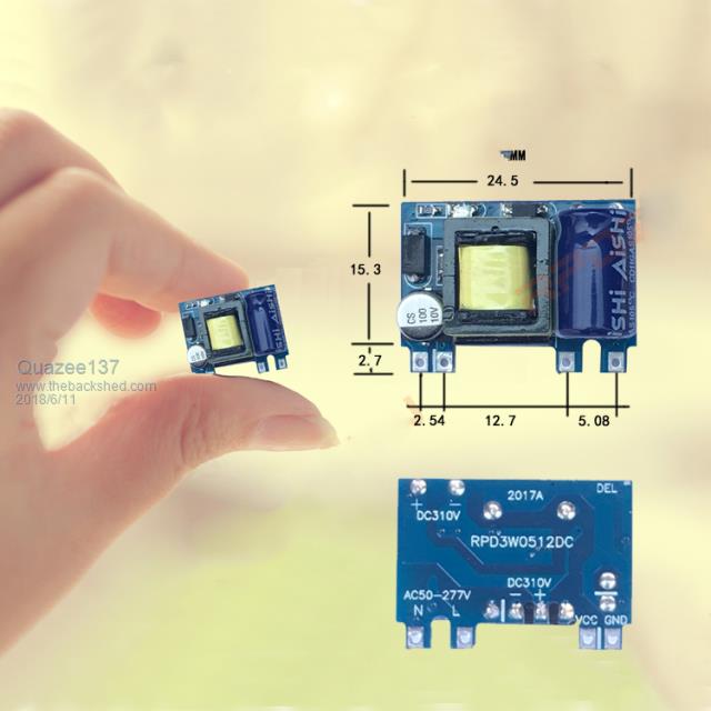

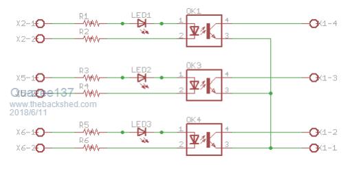

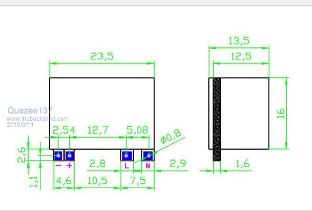

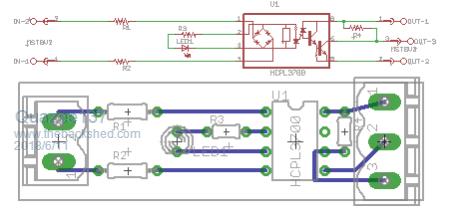

Two parts I have had to used HCPL3700 and MID400
2018-06-11_062309_MAINS_DECT.zip
and cheap 3 phase detector
On a PLC interface we could not use wall wart so we use this
