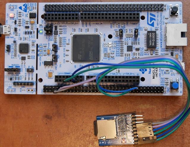

Thought I would create a new thread for the Armmite H7 as I've had a few minutes to work on it. I'll post updates to this thread as they occur and please use it for comments/bug reports etc.
This release supports the normal range of MM+/MMX file handling functions (I hope!!!)
2018-06-09_221110_STM32H743ZI_Nucleo.zip

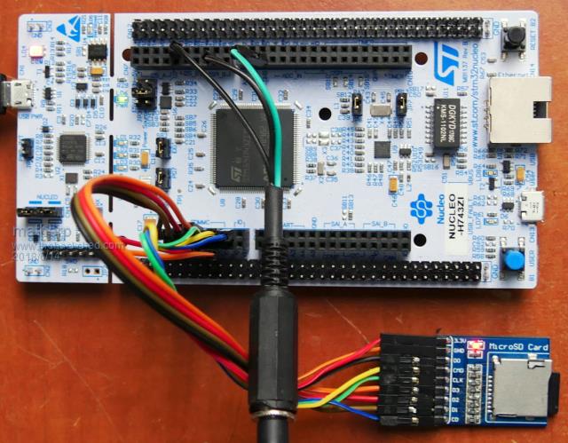

Pinout is fixed:
SD-CS = PF6
SD-CLK = PF7
SD-MISO = PF8
SD-MOSI = PF9
These pins are not available for any other use and there is therefore no associated "OPTION" command needed.

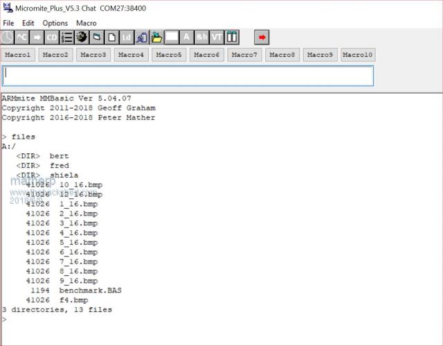

The software automatically detects insertion and removal of a card and will deal with this appropriately. There in no requirement to connect anything to the card-detect output from the sdcard slot
Performance has also been increased significantly

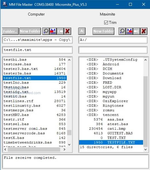

Posted: 08:01am 10 Jun 2018
The MMEdit File Manager is happy with it.
Copy to and from the armmite works well but I have found a bug in MMEdit that cause a lockup (in MMEdit) when you try to copy the edit window contents to a file on the armmite.

The performance of the SD card was not good enough using the SPI inteface so I have converted the code to use the full 4-bit parallel SD card interface. I've also implemented full audio output using the on-chip DAC.
This is a major rework of the codebase as I have converted from a hack of a demo program to a full start-from-scratch CubeMX project (in other words bugs are possible/likely).
The revised pinout is as follows:
PF6, PF7, PF8, PF9: are now available for general use.
PC8: SD-D0 (pin-98)
PC9: SD-D1 (pin-99)
PC10: SD-D2 (pin-111)
PC11: SD-D3 (pin-112)
PC12: SD-CLK (pin-113)
PD2: SD-CMD (pin-116)
PG2: SD-CardDetect (pin-87)
The SD pins are dedicated and may not be used for anything else.
These pins are all available on CN8 (labelled SDMMC) in the order above from the top right of the connector down.

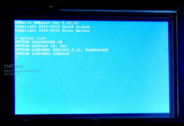

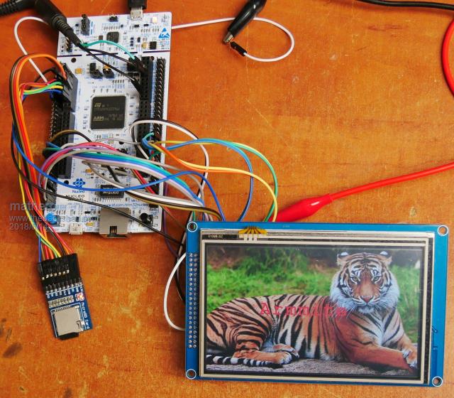

This version now supports SSD1963 displays
Valid displays are:
8-bit RGB888: SSD1963_4, SSD1963_5, SSD1963_5A, SSD1963_7, SSD1963_7A, SSD1963_8
16-bit RGB565: SSD1963_4_16, SSD1963_5_16, SSD1963_5A_16, SSD1963_7_16, SSD1963_7A_16, SSD1963_8_16
The command to initialise the display is
OPTION LCDPANEL SSD1963xxx, orientation
No other parameters are required.
You should set the display to use 1963_PWM for the backlight and then the "BACKLIGHT" command will work
Connections are:
DB0-DB15 on the display connect to PE0 to PE15 on the Nucleo (only DB0-DB7 to PE0-PE7 are needed for 8-bit modes)
SSD-WR to PG10
SSD-RS to PG11
SSD-RESET to PG12
SSD-RD to PG13 (Note this is mandatory)
Remember to connect SSD-CS to GND
NB: the firmware captures all 16 PORT-E pins irrespective of whether 8 or 16-bit communication is used. This simplifies and speeds up the code. Trying to use any of the PORT-E pins when the TFT is enabled will give the error:
  Quote  Error: Pin n is reserved on startup
The picture above is of a 5" display. Note I am having to use an external power supply for the display as the Nucleo was showing an over current warning (LD5) when powering the 5" display direct.
Performance is good. Displaying the 800x480 image takes less than 1 second. CLS in 16-bit mode takes 53mSec.
