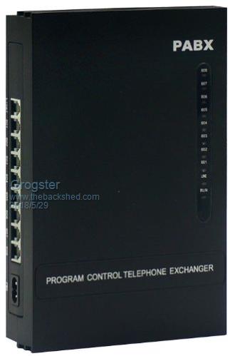

Well, this is really a PABX, but when I went looking for a simple intercom that could have about five stations on it, it was FAR cheaper to just install a basic PABX and use bog-standard phones for ten bucks a piece(or so).
$30 8-Station PABX
I should like to state at this point that this unit will NOT be Telepermitted for use on the New Zealand(Telecom) telephone network, nor the Australian(Austel) network either I would think.
Having said that, and provided you don't bother connecting a trunk line to it(an outside phone line) and just use it as an intercom, the price is just too good to NOT get one to play with - so I have.
It seems to have a quite good feature-set too, for that thirty bucks. Amazing. The unit does not state what voltage it wants, so I asked them, and it is a 220v AC powered unit. Naturally, one of the first things I will be doing with it, is cracking it open to examine it for compliance before I use it for anything.
Intercoms tend to be a party-line arrangement, meaning only two stations can be talking to each other at any one time, whereas with a PABX, you could have a couple of different stations talking to other stations all at the same time. This company also does much bigger PABX boxes, this is just their little baby.
I was about to spend up to a couple of hundred bucks to make a five-station intercom, but hell.....for this price......

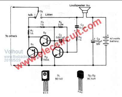

I had something similar to THIS in my house for years.
small box with speaker (that also acts as microphone) and button
You don't need to ring first, just say the word.. and you are heard everywhere in the house.

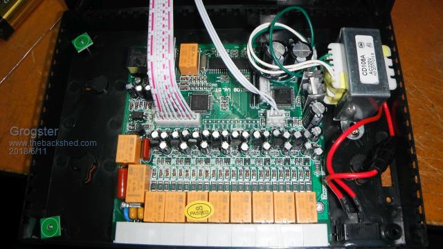

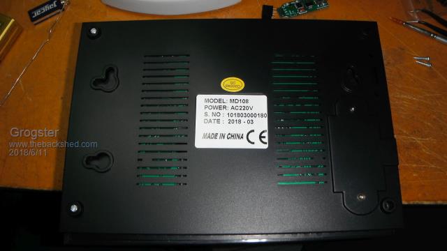

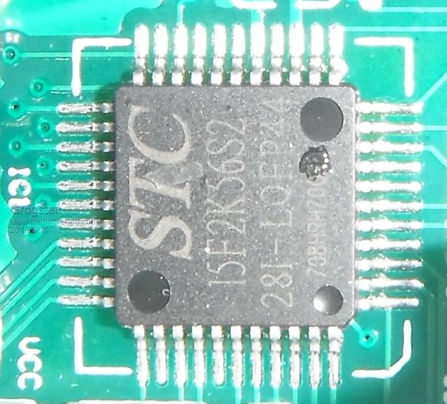

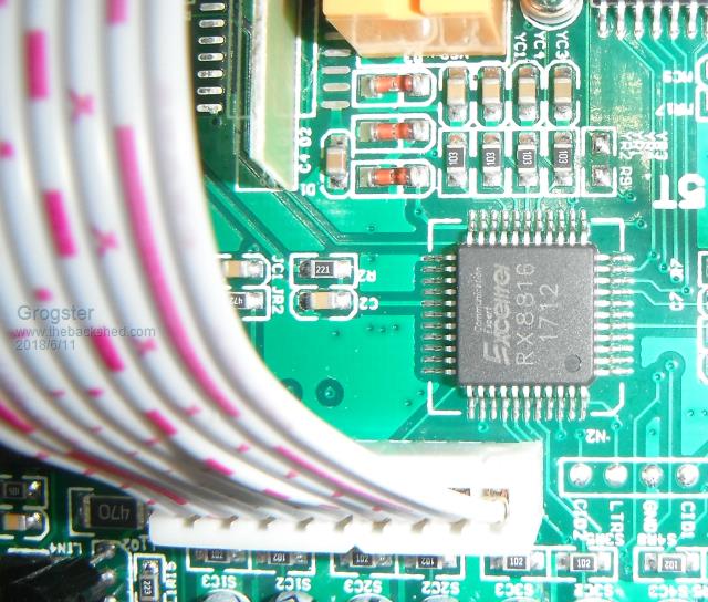

Photos of inside and outside:
Transformer based PSU, which is interesting these days.
Green-Black-Green winding is 25v CT
White-White winding is 82v, which is a little higher then I was expecting to see(around 50v or so) for what I expect is the line voltage.
Switch it on, and it worked with no explosion, so that is a good sign.
I will hook up some phones to it later. Right now, I need to be somewhere else.

It's likely that the 82V @ 50Hz is being used as the ring signal. This would explain why they aren't using the expected switch mode power supply as they want the 50Hz mains frequency. Also typical of low cost devices is that they use a lower line voltage anything from 12 to 24V DC where as the PSTN uses a 48V DC (Nominal) voltage.
If you have time can you measure the line voltage and the ring voltage on one of the lines without a phone connected. I would be interested to know what you find. When a phone is off hook, the voltage is typically around 8V for an electronic phone and 4V for an old rotary dial phone. I expect that the PABX will not work with old rotary dial phones as it will only decode DTMF signals. This should not be a problem as most people don't want to use old rotary dial phones unless they are a telephone collector. The ring frequency of PABX systems was typically 20 to 25 Hz.
It looks like excellent value for money.
