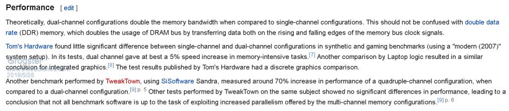

EDIT: I have done a little research on this, and as usual, theory and practice are two different things.
Quad-channel memory would seem to result in noticeable speed increases, but not dual-channel, based on that. I think I will just stick with a single 8GB stick. It's not worth the extra expense of a matched pair, if I don't stand to gain something significant from it.
