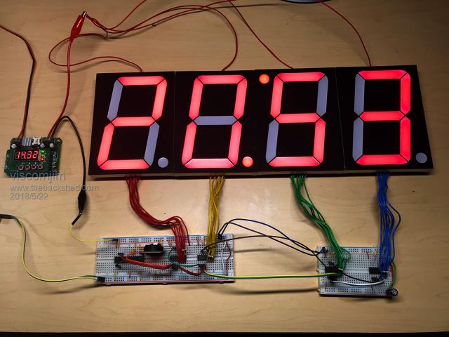

Working on a project for a buddy and he needed to drive some 5" red seven segment displays for a up/down timer. He got a bunch of them for about five bucks a piece. With a bit of googlizing, I found some really neat 7 segment drivers that can supply constant current to each segment with a SINGLE resistor... , not one on each output, just ONE resistor total.
TLC5916 .
Because these displays used 14 leds on each segment (2 x 7) and only 3 on the decimal point, I had to add one more resistor on the DP output to drop the voltage for this weird setup.
The TLC5916s can go up to 20vdc, thankfully, because these displays needed about 14.5vdc to fire up. They are shift registers so you can use SPI mode 3 and make using them very easy. I have hooked up 4 of them and naturally, had to make yet another clock, for testing purposes of course. I took the 3rd digit and rotated it 180 so that the second and third digits decimal points could form a colon of sorts.
The micromite makes this YAC project very easy, a DS3231 module, 4 TLC5916s and you're off and running. The verion 1.0 of my simple test program is only 27 lines of BASIC and shows me the time. Now I just need to add some buttons and a bit more code to be able to set the clock, set 12/24 time, dim the displays using the OE pin on the TLC5916, etc. For this simple test, I just set the time using the console to begin with.

Posted: 04:28am 22 May 2018
Five inch Led !
Mama Mia all my Leds ran away screaming when they saw that.

Posted: 01:53pm 12 Aug 2018
Hi Viscomjim,
Thanks for the project. I must be a little dim but how do the data figures match up to the seven segments. I have tried converting the numbers to binary and some work out, others don't. Where am I going wrong.
Brian
viscomjim
Joined: 08/01/2014
Posts: 925
Posted: 02:25pm 12 Aug 2018
Hello Brian,
The way I came up with the Digit array is I simply switched on one output at a time to see which segment lit up. My wiring from the TLC to the display was random. When I wired the display to the TLC5916, I really didn't pay attention to which segment went to which output pin. I wrote a small program to turn on each output pin, one at a time, and wrote down the value that turned on a segment. So basically I wrote a "1" to the TLC, that turned on a particular segment. Then I wrote a "2", that turn on a different segment. Then 4, 8, 16, 32, 64, and 128. Once you see which segment lights up for each output, you create the digit by adding up these numbers. Easier to see in binary.
So, for example, in my program, Digit(1) = 20
20 in binary is 00010100
So writing 20 to the TLC will turn on outputs 2 and 4 which, because of my particular wiring, turned on segments B and C, to create the number "1".
You can see also that adding 128 (binary = 10000000) to a number (output 7 on the TLC is hooked up to the decimal point) would light up the decimal point.
I hope that makes sense.
If you tell me which segments on the display (A - G and decimal point) are wired up to which outputs (0 - 7) of the TLC, I can create a Digit array for you that will work, if my explanation above doesn't make sense.

Posted: 09:16pm 12 Aug 2018
Probably another one of my stupid questions but why isn't it multiplexed.
PaulEdited by palcal 2018-08-14
Posted: 09:18pm 12 Aug 2018
@viscomjim
very nice, lovely displays and sweet design.
My only comment would be concerning the line in your code :
SetTick 60000, SetClock, 4 'Interrupt to fetch DS3231 time every minute
I'd call this at much faster intervals, the clock in the micromite drifts and you are very unlikely to refresh the time at the right intervals (60 seconds of MMTime is going to be out from real time), you might even get 2-minute minutes.
I'd scrap ticker 4 and call it every time round in the loop instead, so the system clock very closely tracks the RTC and any changes are only a few mS behind.
other than that, pretty faultless project, nice!
my 2p
Posted: 09:20pm 12 Aug 2018
  palcal said   why isn't it multiplexed.
each driver chip handles its own display, the data is daisy-chained through the four of them (they have a data-in and data-out to the next chip) so there is no need to multiplex. You just pump the data through the first one connected to the MM, stop after four bytes then latch the data in each one's shift register.
Its a nice chip, it takes away all that tedious mucking about. For a custom display I think it is pretty good - the only (small) downside is the chip only comes in common-anode flavour as far as I can see, which kind of fits as the outputs will sink current at up to 20V, but getting them to source it at the same would require another voltage pin (Vdisp) and there are no NC pins available - it would have to go to a bigger footprint.Edited by CaptainBoing 2018-08-14
