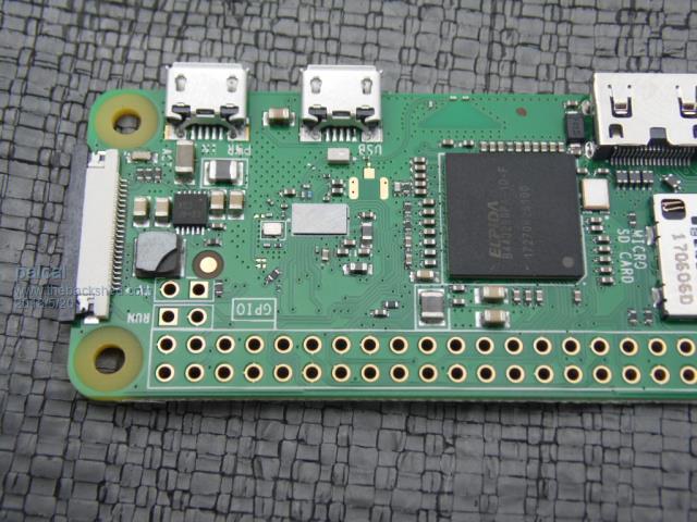

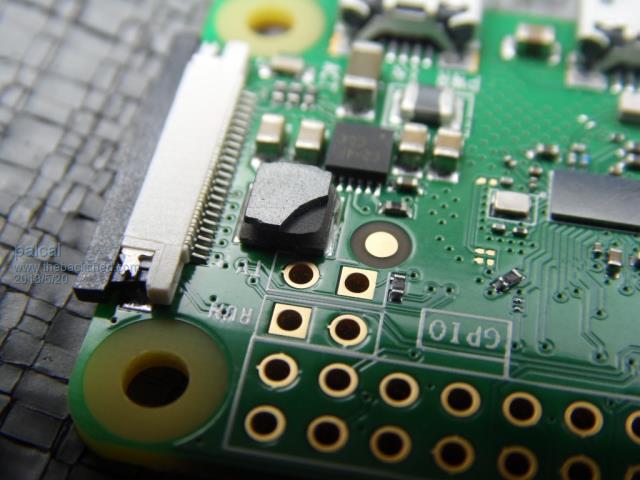

Does any one know what the chipped part is. I have found a picture where it has 4R7 printed on it so I am assuming it is a 4.7 ohm resistor and by its size maybe .5 watt, I thought maybe someone could confirm that. I received this board damaged and the seller is sending a replacement so I thought I would see if I can repair this one.
Paul.
edit... When I first applied power the green led fickered but now nothing so I am thinking it is a resistor in the power supply circuit. I can't find a pi zero Schematic anywhere.
edit again.... the reason the led stopped fickering was because I had removed the sd card. I know nothing about pi zero the led flickered for a while and now it is on steady, was it reading the card. I will have to find a tutorial somewhere.Edited by palcal 2018-05-21

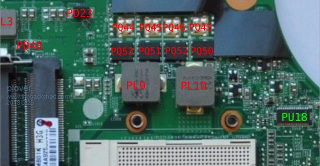

My opinion is also it ought to be a 4.7 ohm resistance high power, then again I believe there are inductors looking like this, find buckets of them in a laptop, I should have been able to remember better. Will see if I can chase something up.
In the mean time, have you checked with a multimeter to make sure there is conductivity as you should have independent of being R or L of course may be you need to remove it to be absolutely sure.
Yes circuit diagram would be nice, just did a quick look on the internet, here is a pic from some work I did trying to repair a laptop.
Sorry about details but it gives an idea of what an inductor may look like
They may have more writing than a resistor upon them. PL are inductors, some mosfets above give size idea
Edited by plover 2018-05-21

I believe that you'll find it's a 4.7uH inductor. The layout with the IC next to it is textbook switching power supply.
Posts: 10114
Posted: 02:34am 20 May 2018
I tend to agree with ryanm. When I looked at my Pi-0 under the microscope, you can clearly see that there is enamelled wire going in one side, and coming out the other. It is sealed up in black gunk, probably to stop any HF resonance from being heard.

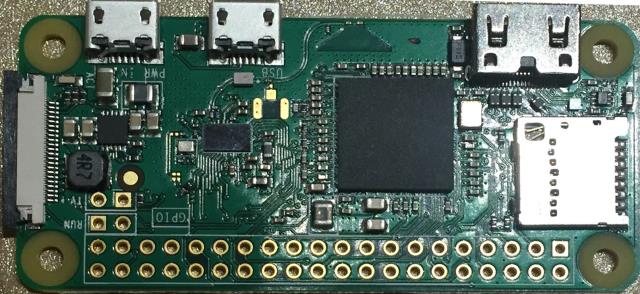

Hi Paul,
I dusted off my Pi-W and the PCB looks identical to yours except for the broken component,
Mine has a clear marking of 4R7 in black printed on the device.
Mine has a short across it and connects directly to pin 1 of the header which is 3v3.
My guess is it has to be an inductor of 4R7 micro-Henry (??? not sure but I think it might be u-Henry)
I reckon you could safely short it out.
Kind Regards,
Edited by bigmik 2018-05-21

Hi Paul,
Just looked at my Zero-W (which I've yet to fire-up) and I think the 4.7 device is more likely a 4.7uH inductor. Reason is that the 12 pin chip alongside it is a 2306KE (just managed to read it with a magnifier) which is a step-down regulator so that needs an inductor and the smd versions of them look like that one.
There's some info on the Pi forums and RPi Stack Exchange here but not a direct answer for you.
Greg

I wouldn't be surprised if it still works once you've loaded an OS onto the SD card. Loosing a chunk of ferrite material will alter the inductance a bit, but I can't see any coil broken. SMPS usually have a fair bit of tolerance for varying inductance values and the chip brand new out of the factory would only have had an accuracy in the +- 20-30% range.

Here is a photo of my Pi-W
Kind Regards,

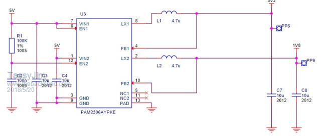

Posted: 03:07am 20 May 2018
Schenatic of the pi zero W power supply areas.
Extracted form
https://www.raspberrypi.org/documentation/hardware/raspberrypi/schematics/rpi_SCH_ZeroW_1p1_reduced.pdf
4.7uH stands out as a likely suspect.

Thanks for all the replies, after that I am sure it is an inductor, I didn't think they used R with an inductor but there you go. Looking closely at the broken component it sure looks like ferrite. However I burnt an SD card with Raspian stretch and the blinking LED seems to be the file loading, after a while the LED settles down solid green. So I think all is OK. I was like a kid with a new toy and instead of reading a tutorial I just started connecting it up. But need a USB hub and an adapter cable for the monitor. I really only bought it to play with the Picromite but now I think I will play with it a bit more first.
Paul.
