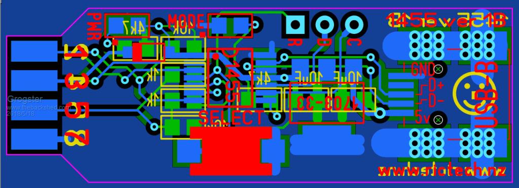

I found that more and more these days, I need to have both the ICSP pins AND the console pins at the ready. To ease my stress level having to keep reconnecting things between ICSP mode and console mode, I decided to build a special programmer/debugger tool.
The board is 43mm x 15mm so quite small. The 1455 chip is SSOP. All passives are 0805, regulator is SOT-223. It was after I ordered them, that I thought that the SOD-123 diode on the 3v3 line is probably pointless, as the 3v3 pin will actually be around 2v7. The idea was to stop an externally powered circuit from coming back into the output of the programmer regulator. The 1455 chip does not care about the 3v3 line like the Microchip PK3 does, so I guess it does not matter that much.

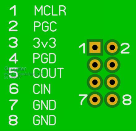

The business end of the unit has a 2x4 female header mounted with the board in the middle of the two rows of pins. This could be male, and the boards female if preferred, this is just how I do it. It is a standard 2.54mm 2x4 header with the following pinout:
What I like about having the ICSP and the console on one common connector, is that you can program the HEX into the MM using the ICSP pins, and also talk to the console on the same header, all via the one unit. This saves a lot of wire-swapping between ICSP and console on boards that DON'T have the 1455 incorporated. And cos the 1455 chip automatically drops out of ICSP mode back to serial mode when it has finished programming the HEX into the chip, as soon as that is done, you can just open the COM port and start talking to the console without having to change anything.

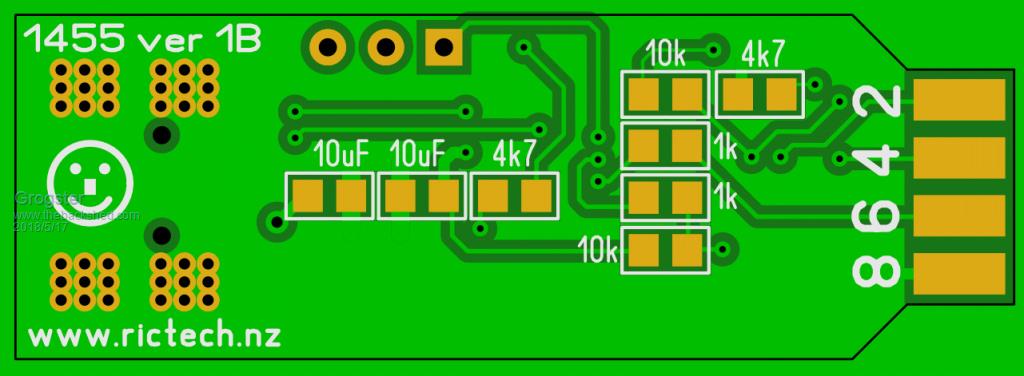

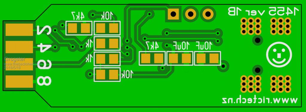

Also I: Is it possible for your bottom board photos be flipped / rotated end to end. It may make it easier for me to mentally line up the top & bottom components & tracks etc.

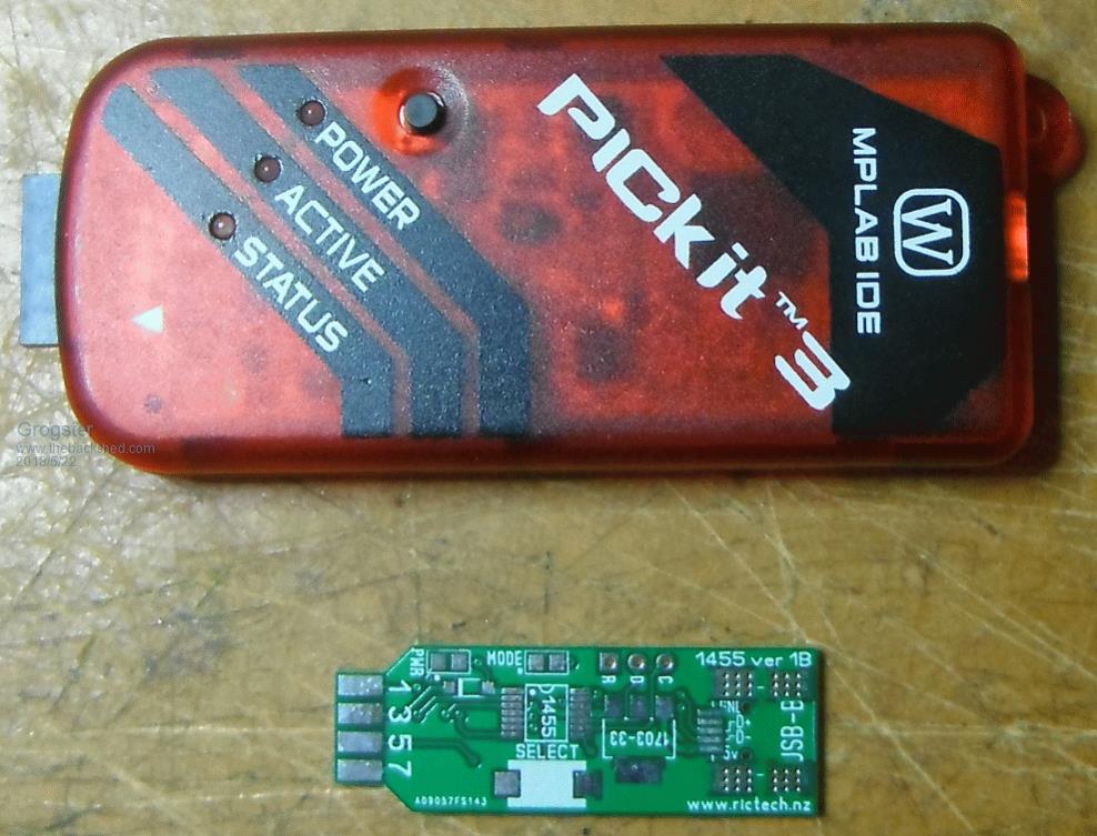

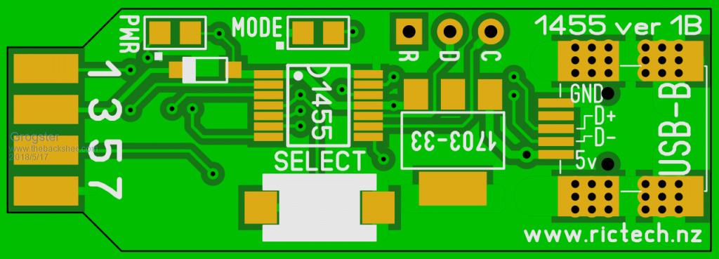

The board images are flipped horizontally, as that is how you would look at the board, if you turned it over horizontally. How about an image showing both layers:
The 1455 is both a USB-serial adaptor for the console, and also a programmer so you can load any new HEX file into the PIC32 chip at the heart of the Micromite, without having to use the Microchip IPE(and it's massive IDE download) or a PicKit-3 programmer tool. Press the SELECT button to put the unit into ICSP mode, and program your HEX file firmware into the PIC32 chip.

Here are both images just for you.

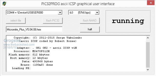

To upload a HEX to a PIC32 chip, you use the 1455 as the programming tool, and PIC32PROG.EXE, which is a command-line programmer co-developed by robert.rozee and Serge Vakulenko. Rob write a nice little GUI for the front-end, so you can do it all with just a few mouse clicks:
The procedure is:
1) Connect the 1455 to your Micromite chip
2) Press SELECT button to put the 1455 into ICSP programmer mode(LED lights)
3) Run pic32prog GUI, select HEX file and COM port that the 1455 is on
4) Click "Flash PIC32"
That's all there is to it.
"Flash NANO" is an option for the original concept that used an Arduino Nano as the basis of the programmer. You could click this button to load the code into the NANO module to make the programmer work. You can safely ignore that button, as we don't use it anymore.Edited by Grogster 2018-05-19

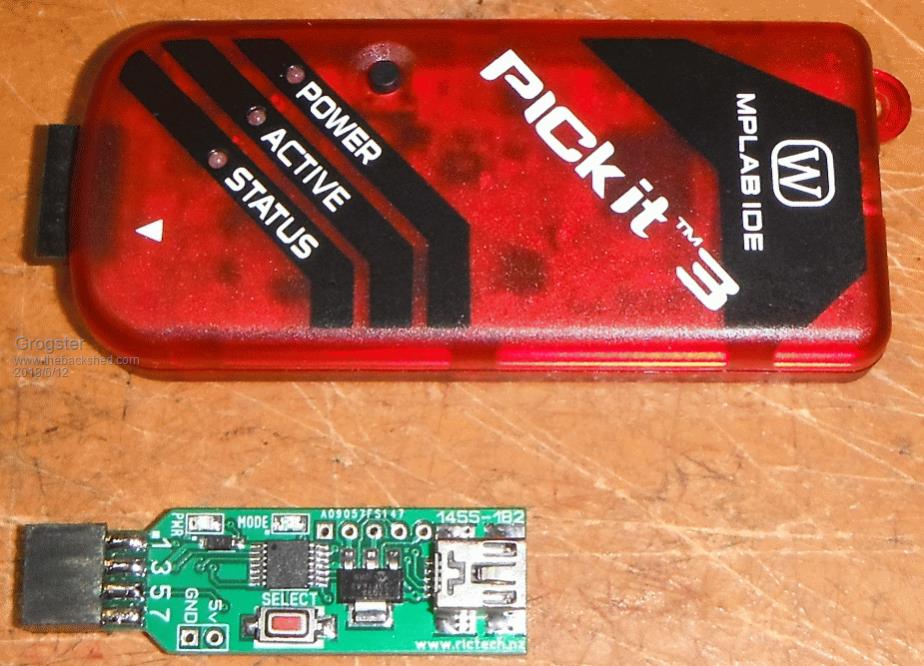

The PCB's for this have arrived. I hope to build one in the next few days.

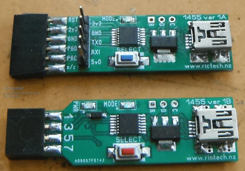

Photo of a PCB shown with a PK3 for size comparison:
Posts: 10114
Posted: 10:55pm 11 Jun 2018

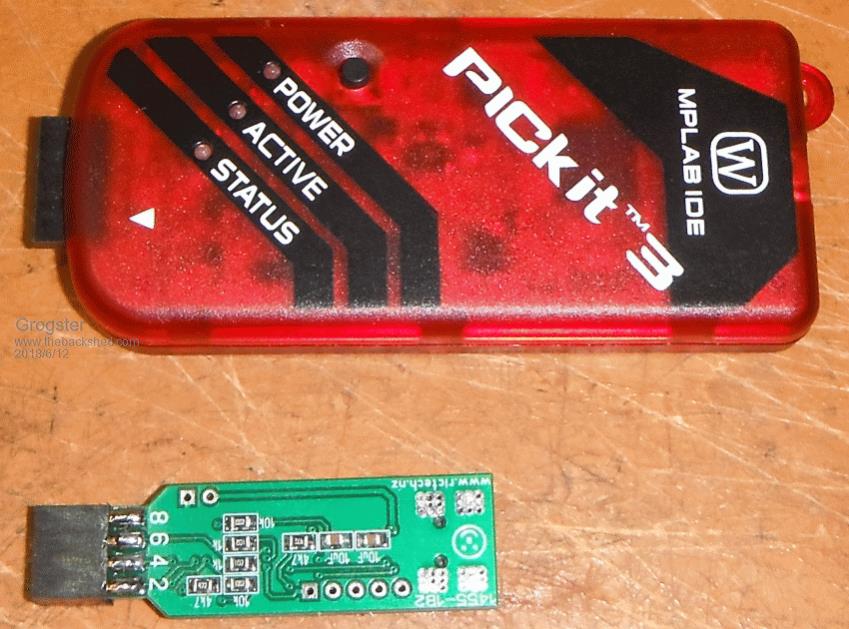

Updated version 1B2 with standard 5-pin 2.54mm ICSP holes for easy programming of the 1455 and a couple of other minor layout tweaks.
Shown with a PicKit-3 as a size comparison.

This looks interesting.. but you have me a bit confused as to how it plugs into a standard 6 pin SIL header?
The pinouts do not seem to lend itself for that and look like they require jumper wires to connect to your device
Posts: 10114
Posted: 11:52pm 11 Jun 2018
It doesn't.
The ICSP 5-pin is there just so you can program the 1455 using a PK3.(ignore pin 6)
Once programmed, you don't use the PK3 anymore, you use the little board as a MM programmer and debugger unit. The 2x4 female header at the left end in the photos, contains all the connections for ICSP and also the console, so you can program new MM chips AND have the console connected all at the same time.
I got sick of swapping wires around between a PK3 and a serial module for the console, so built this thing which does both at the same time thanks to the 1455's ability to do both.

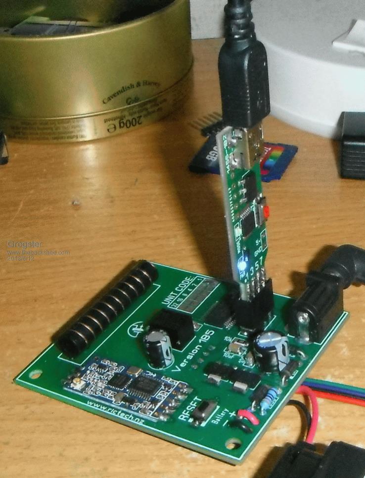

I have now started using a 4x2 pin-header on all my projects. It is reasonably small, and gives me the ICSP and the console in the one pinout.
EDIT: Here is a photo of how it plugs into a board:
With the ONE connection, I press the SELECT button on the little programmer/debugger thing, program in the MM HEX file. Once that is done, the programmer drops back to serial port mode, and I open a COM port to it - all without having to change anything or move any wires.Edited by Grogster 2018-06-13
