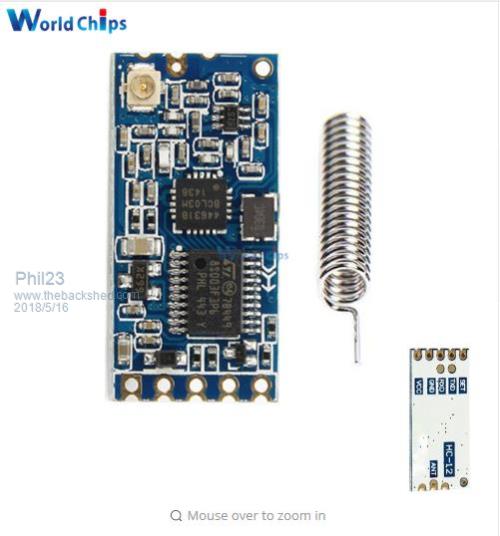

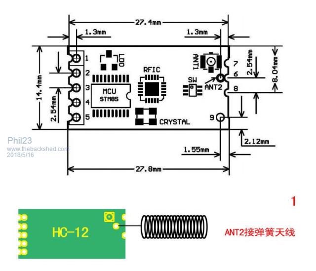

Geez,
It's a bit hard to pic some, but I notice a lot of Ali sellers are using these pictures & no close ups of the modules.
Also stumbled over this one,
That shows a black crystal in one of the pics.
Not sure it they are rigidig or not.
Phil.

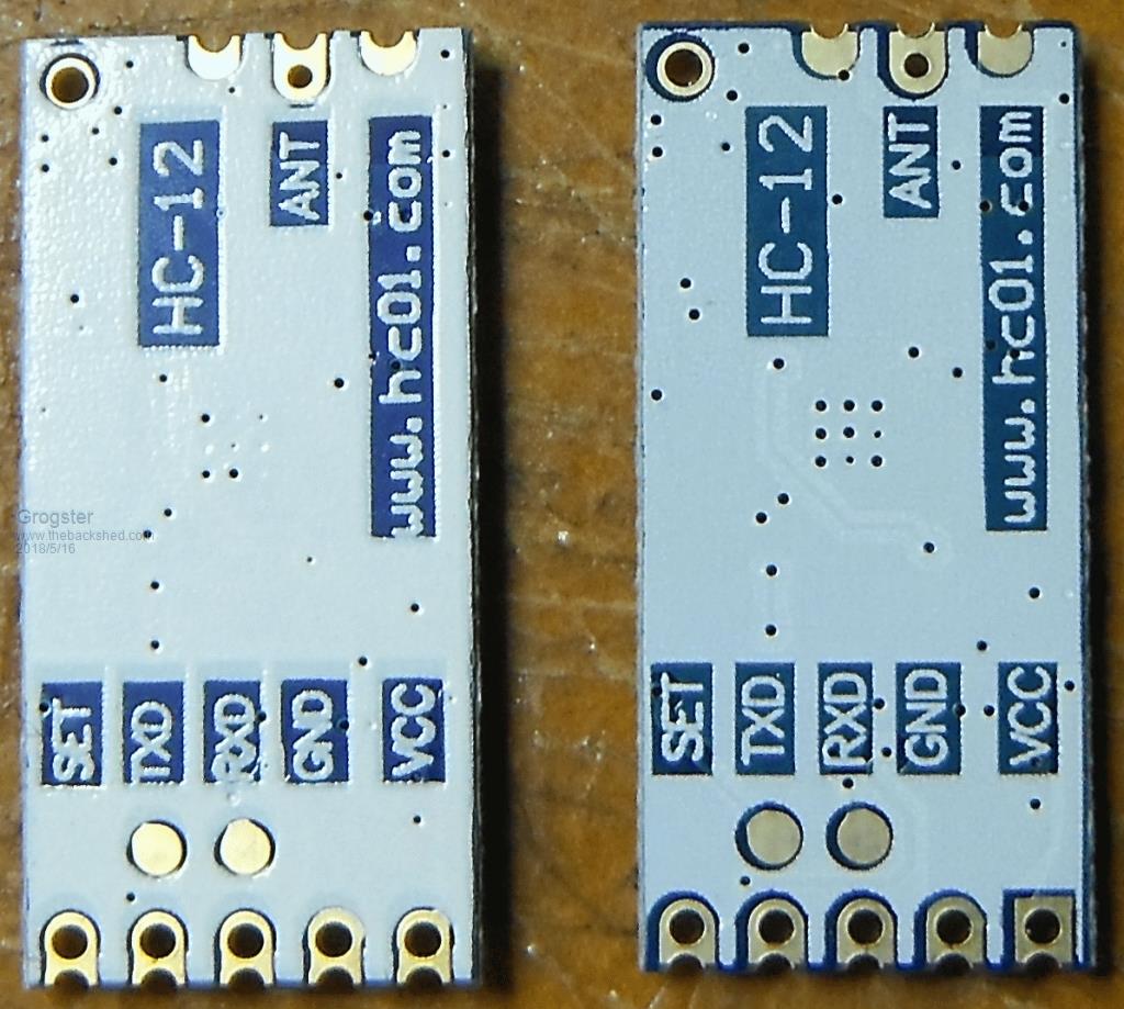

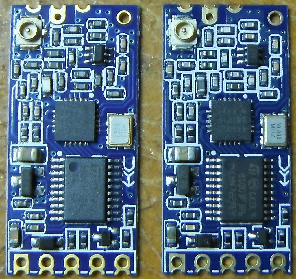

Here you are then - some close up's!
The GENUINE module is on the LEFT in these photos.
The fake one is on the right.
As you can see, there really is not much between them, and to the untrained eye, they are identical. That makes it harder again to spot the fake ones. The genuine ones have a much 'Whiter' silkscreen on the bottom, and you can't really see the track under the silkscreen. The clones have a thinner silkscreen, and you can easily see one track that stands out on the back. The connections also appear to be dull looking on the clones, but bright and shiny on the genuine ones.
Genuine ones have a square pad on the top for VCC, but it is ROUND on the bottom of the PCB. The clones have a square-pad on both top AND bottom for VCC.
Don't put any faith in the photos that the sellers use. They are most likely taken from the genuine article, weather they are clones or not. IE: The clones will be sold with photos of the genuine ones on the listing.Edited by Grogster 2018-05-17

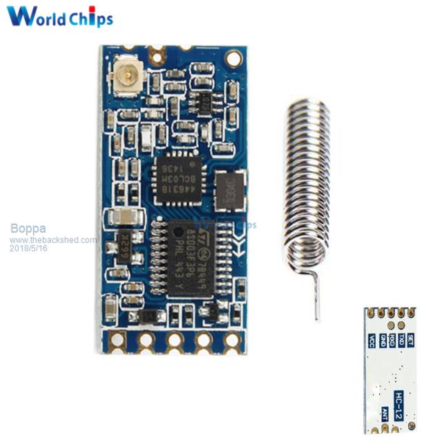

Interesting that one in Phil23's post, I tried to read the crystal markings but it really isnt clear enough- possibly t304c???, but close inspection of the pcb would seem to be a legit one with the round lower VCC connection...
but then on that site, it has all the photos with the black crystal, except one where its a goldish looking one... so obviously they have a mixture of photos of different units...
It sounds like building a list of sellers with ones selling known real HC01.com ones, and ones selling the clones/fakes (also handy to know those for people already locked into them in existing networks)- now with a possible third variation (real but with black crystal???- that would need to be confirmed though)

I have no idea on the black-crystal ones. I have never been sent any with that crystal. I fully expect those to be fakes too. You could run that past your contact at hc01 and let us know.....

I would call it a clone rather than a fake Grogster, it doesnt have the hco1.com badge, so it technically isnt a fake, unlike the ones that do have the hc01.com lettering but arent from them...
Its performance would be the deciding factor in whether it would be an acceptable buy, for that we would have to get one and test it I suppose...
